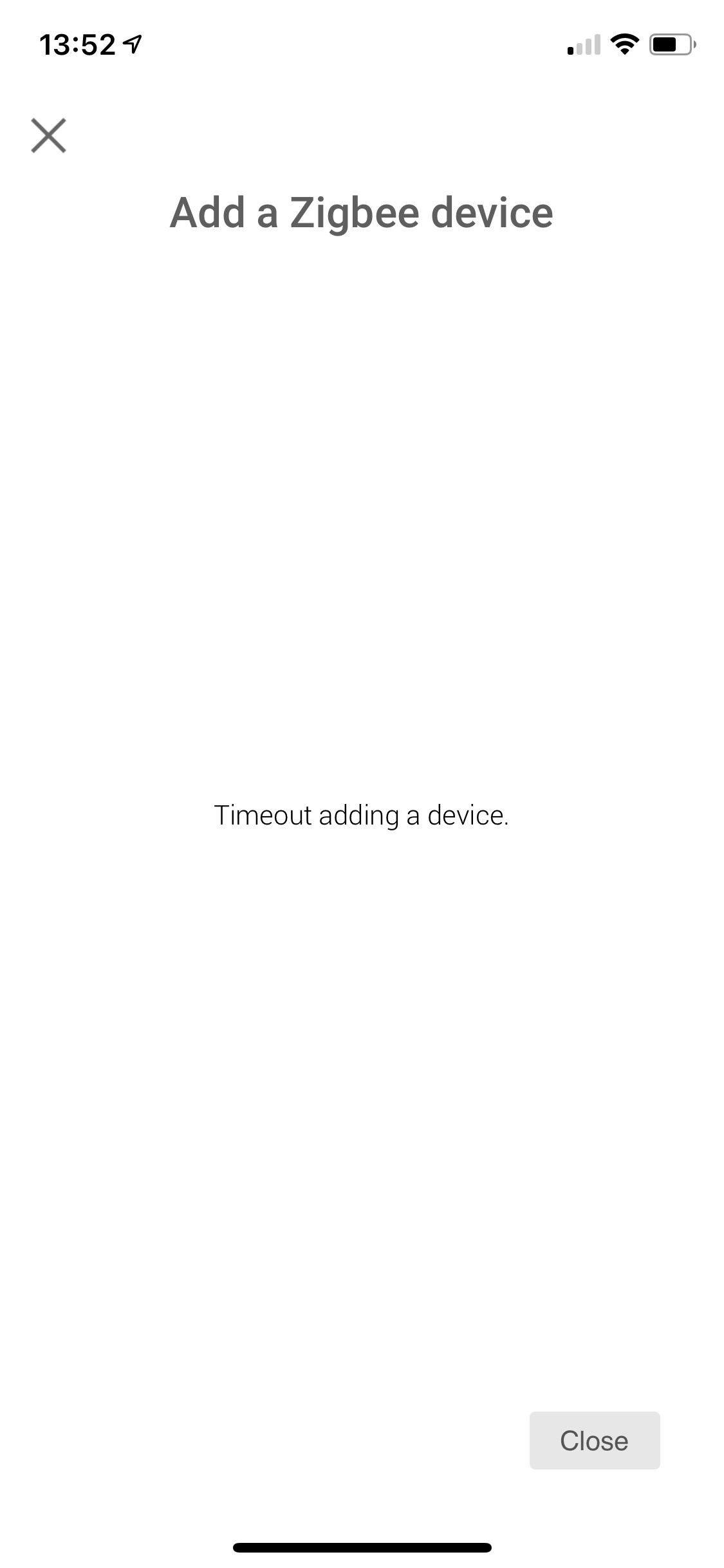

Today i bought a Xiaomi Door and Window sensor, but i get timeout everytime… I already restart the Homey, and always get timeout. Any idea?
You probably mean “At Including” , solution, when the including starts, keep pressing the button every 2 seconds until the including completes.
