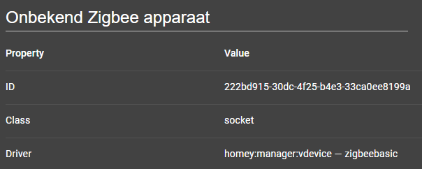

Thanks for the update @TedTolboom
this is one that is added like a generic zigbee device:
and this is the one that is functional:
image image
hope this helps
Yes, it does… Although we initially though differently, you are (as with 97% of the app users) still running on Homey v4.2.0 and the app version 0.8.0. Which I can see since as of Homey v5 the zb_profile_id and zb_device_id are no longer used / reported.
In Homey v0.8.0, the manufacturer name LUMI linked to the light sensor, like with all other Xiaomi / Aqara devices. After the release of v5, I learned that Xiaomi has released a “new” version that reports XIAOMI as manufacturer name… Since this is not declared in the app, it is not recognized during inclusion.
In the v5 compatible app, I’ve already added the additional manufacturer name. But I can’t update the current v4.2 compatible app due to a limitation to the App Store.
If you have the option to install the app through the command line interface, I could release an update to the GitHub repository.

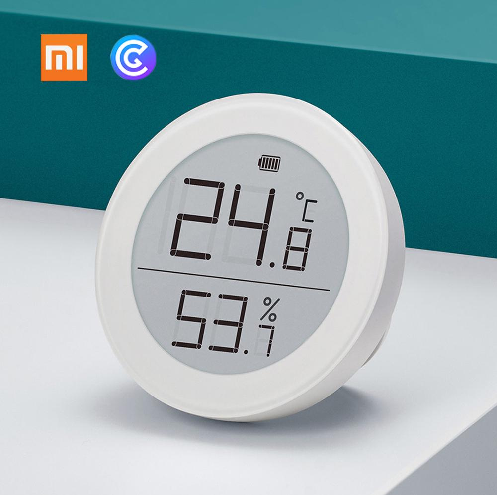

Xiaomi/ClearGrass/Qingping bluetooth e-ink temperature sensor:
I have them and the e-ink screen is the best solution on the market to this day.
@the_MANAGER that’s a BT device, and my guess would be that it depends on NOTIFY characteristics, which aren’t supported by Homey (and I don’t think firmware v5 changes that). Given that a support request for these types of characteristics was made almost 2 years ago, and they still aren’t supported, doesn’t give me much hope they will be supported in the near future.

Reading through the Zigbee app topic might not proove to be the best strategy… when looking for a BT sensor…
I’m not looking for a BT sensor. I have them already.
I’m not looking for zigbee sensors with lcd display.
I am looking for a zigbee sensor with e-ink display.
Meanwhile, I took the opportunity to ask TED if he, as a developer, knows if that type of BT sensors are supported by Homey in any way (until I find the zigbee ones), as I could not find the info myself … and he’s active on many topics, and is involved in development, thus knowing more than me.
So, if anybody knows of some temperature sensors with e-ink display … thank you in advance … :wink:
