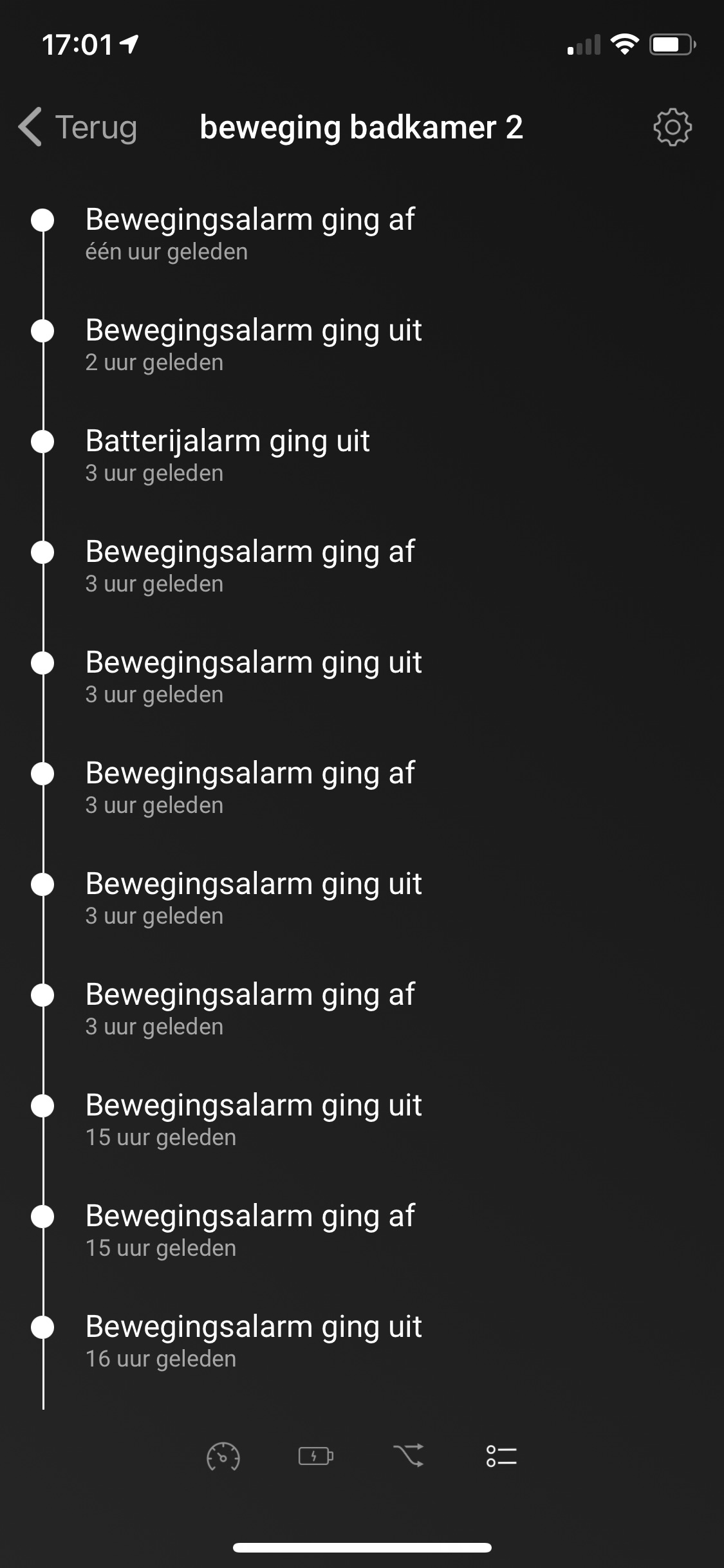

I have the same problem, after the update some random motion sensors are stuck in the trigger state. The sensor in my bathroom for example is triggered for more than an hour now. I also get a lot of devices that report battery status since the update(see screenshots)

I can’t believe it, but I noticed fake motion alarms now on 4 sensors during last few hours - different sensors, different locations…so you may notice it right after all @Igy

Thank you - btw also it seems those sensors get stuck in motion detected then, while move and/or waking them up using pair button seems to return them to correct state.
Also it’s happening quite randomly, not sure if it will help but here is diag. after reboot and after waking sensors up (as they were stuck) - 3623100e-7ffc-42d4-86ca-4c0b3fcf6bb5
The false triggers of the motion sensor should be fixed (or contained) with release v1.1.4.
It was an issue originating from the lifeline report parser used for the battery reporting that also updates the alarm state, which is working correctly for the door sensor, but not for the occupancy sensor.
