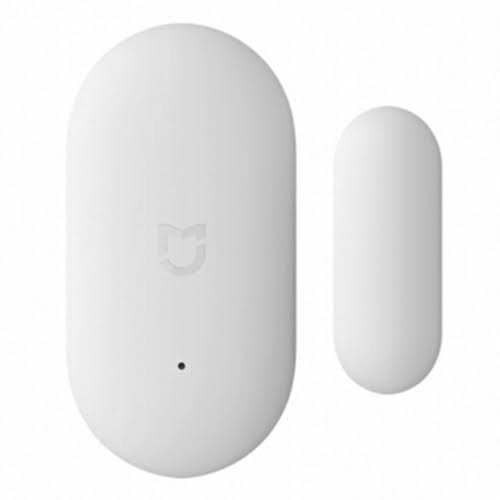

Nice work Ted. But what do mean with old Xiaomi devices? Will this door sensor show battery percentage?
Does it have a battery?
Yes, they does for me - nice work @TedTolboom ! I thought it’s not possible
