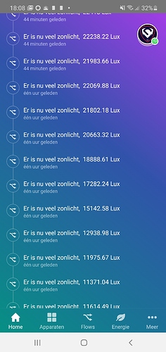

Is the update frequency of the light sensor changed in the last version of the aqara app?
I got far more updates now?
Is this giving a high load for homey?

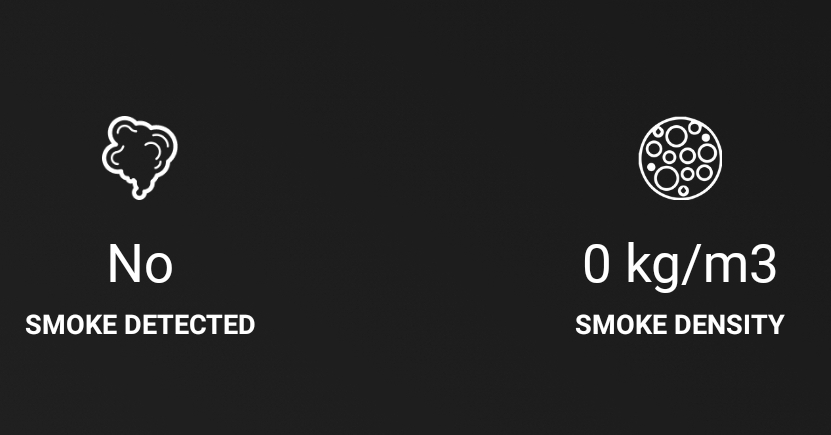

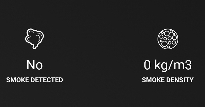

Is there a possibility for the smoke sensors to do the self test, like with the original Xiaomi hub / app is possible?
Awesome work by the way! I’ll buy you a beer (or a hot chocolate when I look outside :laughing:) again when I’ve upgraded to the new stable app.
That would be awesome.
@TedTolboom, would it be possible to actually also implement smoke density? Xiaomi app via gateway has it and it’s actually good way to see sensors still works.
yes i did. Today i resetted my zigbee network and added al my devices again( this time my routers first) also added the devices from te place where they are going to be used(so not close to homey). and i see routes! and it looks like its way more stable till now!
Should be feasible. Could you create a feature request for this one on GitHub?
Yet another carrot on a stick? :thinking: In the future, I’ll have to become rich…
If possible to provide me a hint on how this is reported by the device, I would appreciate it. Like also mentioned earlier, please create a feature request on GitHub, so I can track the different requests.
