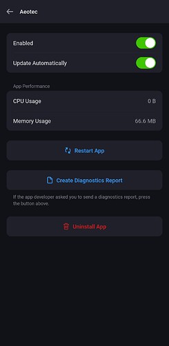

I would generate two diagnostic reports, keep notes of the diagnostic number and contact Aeotec support Support - Aeotec
  1. One for Aeotec support: under Aeotec app, settings
  2. One for Homey support if needed later. Under Homey settings, general, at the bottom
After that, you can then try to restart the Aeotec App
