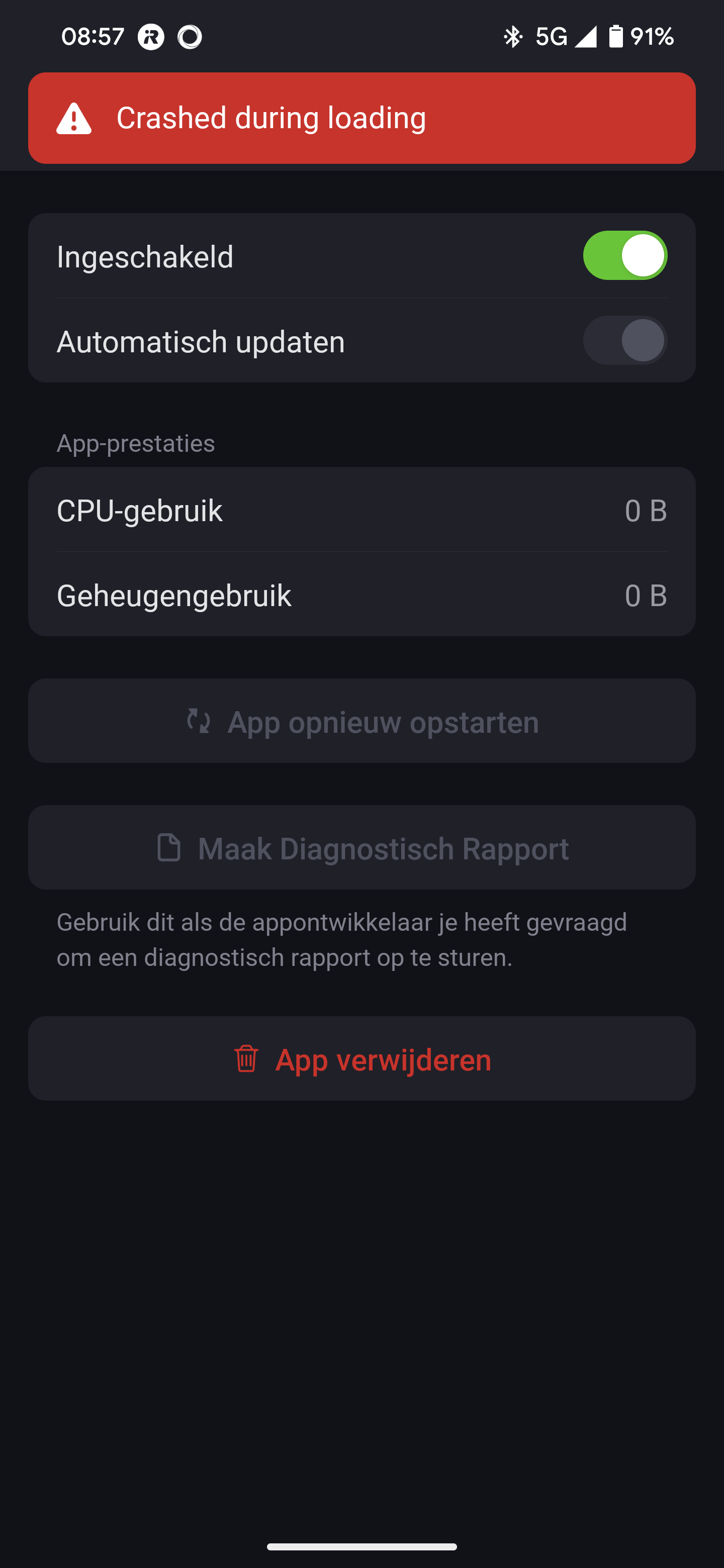

After last night’s update on my homey 2016 not an single app is working. Did a reboot a few times but doesn’t work. More people experiencing problems?

Can you start the sysInternals App again?

Nope, not possible
