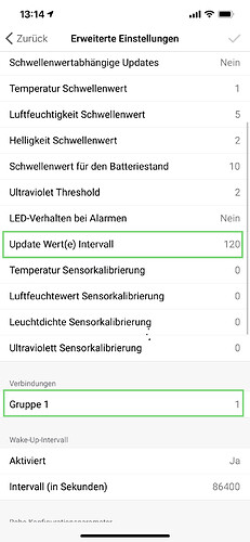

Valid is the wrong word. The raw configuration of the parameter 101 and 111 are also valid, but you can change them much easier by using the green marked parameter in the screenshot (sorry, only in German language):

Looking at your settings, you seem to have 120second refresh but other interval is 86400?
I make it easy for myself. If you tap on the parameter “Update Value(s) Interval” or “Wake-Up Interval → Interval (in seconds)”, then the parameters are explained.
In short: “Update Value(s) Interval” has nothing to do with “Wake-Up-Interval”.
If this is not understandable enough, please let me know.
120 s: Homey receives every 120 s (new) values from the sensor.

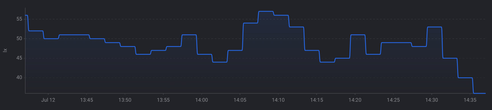

This is the insight chart for the lux value:
And this should maybe the point: New Values
So maybe it’s like I guessed in my first post:
My Wake-Up-Interval of 86.400 s doesn’t matter because my sensor is powered by USB.
