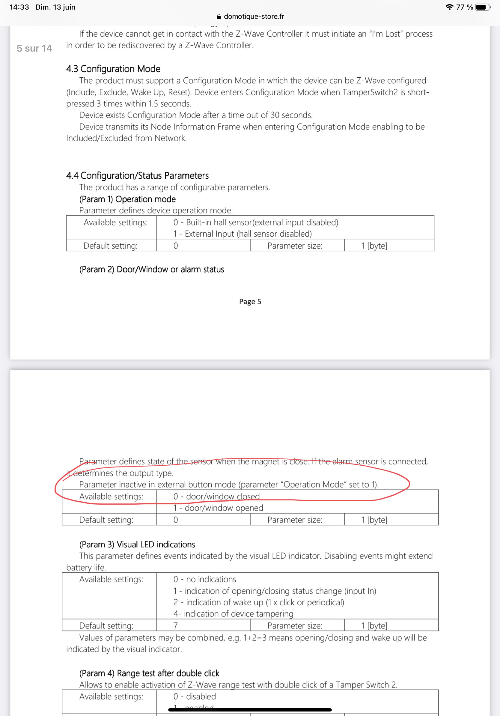

Change the setting for “polarity”
Changed but no effect … as written in the manual …
A nightmare… I changed many parameters without any effects
