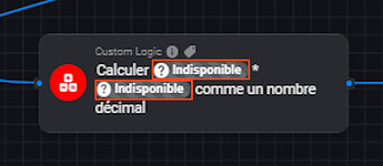

In addition to the already mentioned mistake that an “ALL” card will never work with action cards, there are also errors in the calculation card of the Custom Logic App:
I think that’s what you’ve explained here, isn’t it?
Even though I don’t use either app, I’m pretty sure you made a mistake. Because such grayed-out tags are displayed when a flow card or device that provides these tags has been deleted.
