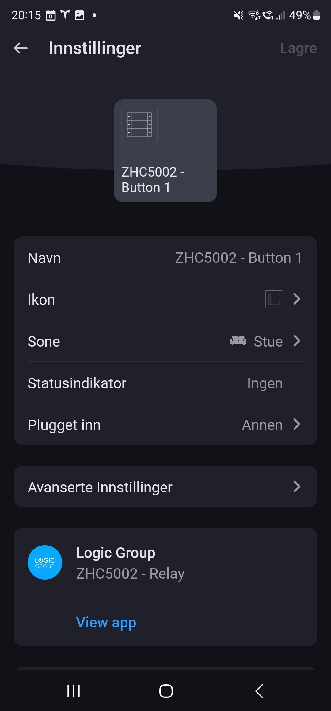

Hello Just switched from homeseer to homey pro. Have a sene switch on which I get this error message when I try to set parameters in advanced settings. Anybody have any tips? Worked just fine with my old homeseer. Have tried removing and adding the device again.
