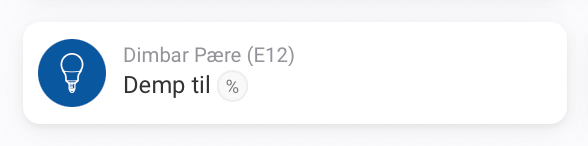

Instead of this flow card:
…you need to use this flow card:
However, it would be important to know what exactly doesn’t work after midnight! Is the light too bright? Too dark? Turned off?
It looks like that worked the charm. Did some testing now and it looks like its working.
It was mainly that the light didn’t change according to the plan when the clock hit midnight.
Yes, because you used the wrong flow card. The light was not dimmed to an absolute 10%, but only by 10% of the previous brightness value.
