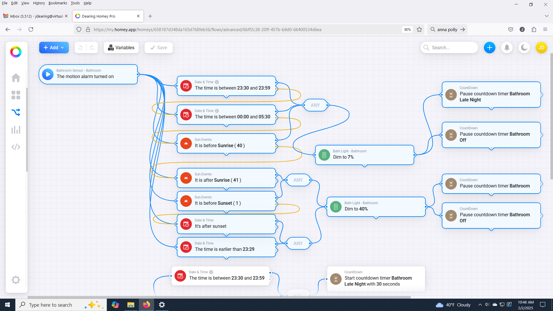

A few weeks ago I posted the flow for the Bathlight/Motion Sensor flow and was looking for feedback. Thank you to all that offered your insight. After letting the feedback “marinade” I re-wrote the flow with more defined dayparts, AND IT WORKS PERFECTLY…almost. The one misstep is WHEN the motion sensor senses motion AND the time is between 11:30p and 5:30a THEN turn on the lights to 7%. The result is that for the first second (if that) the lights turn on to 40%, then an immediate dim to 7% instead of just coming on at 7%. When you are barely awake that flash is not fun. The flow is below, if you see what is causing that flash and the tweak needed to fix, I’d be grateful.

My fix was:
Instead of just having the light turned off, change that by adding a step in your flow(s):
dim the light to 7% and then turn it off
Now the light always starts at 7% before it gets dimmed to the programmed dim values.
-The AND-cards ‘The time is between 00:00 and 05:30’ (card 2) and ‘The time is earlier then 23:29’ (card 5) are both true at, say, 04:00. The first one will try to dim to 7%. The second one to 40%
-You can combine ‘The time is between 23:30 and 23:59’ and ‘the time is between 00:00 and 5:30’ and use ’ the time is between 23:30 and 5:30’
-At 04:00 it’s not after sunrise but it is before sunset (cards 4 and 5). you should use an ALL-card instead of ANY. Or replace both with ‘It’s Daytime’
Thanks for the reply. I tried that I still get the bump of lights at 40% and then quickly dim to 7%
Wim_Post Thank you for the great feedback. How would you deal with the time between 5:30a and local sunrise when the light should come on at 7%. ?
In the morning you want to dim to 7% after sunrise or after 05:30 whichever is last?
And in the evening after sunset or after 23:30 whichever is first?
Great thanks
