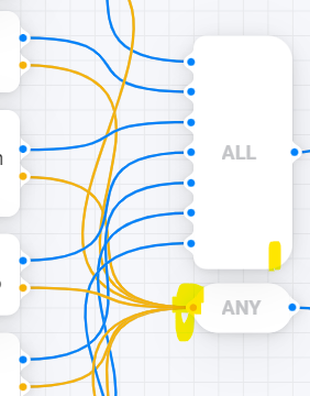

  3. Issue: no option to connect an ELSE/NOT to an ALL block (e.g. right bottom, similar to AND cards). That’s a common use case, and with an additional ANY block + all connections it gets messy:

I think this will not work.
Say you have three connections to the ALL card.
First being just an “if A less than 10”. That will be a quick check.
Second could be a delay card followed by a if-greater card. This will reach the ALL card delayed.
Third could be multiple cards in seriel and might not even reach the card before the ALL card.
So when should the ELSE part of the ALL card be activated? The logic for the ALL card needs to know everything of the logic before it.

I mean something like: NOT (A and B and C and …)
It might not be optimal performance-wise because it needs to wait for at least the first false result (A, B or C) in the ALL, but it then it should work?
So if the ALL part (A and B and C and …) evaluates as false, the NOT connection activates.
The ALL element is waiting for input and only executes the outbound connection if ALL inputs are true.
The ALL element doesn’t know about a previously executed element with a false state.
To get a “all false” state (A and B and C) == false, you need to connect all false lines to a second ALL element.
To get a “one or more false” state, your example is right. All true lines together at the ALL and the false lines to the ANY (only one false is enough for it, so it’s a NOT (A=true AND B=true…).
