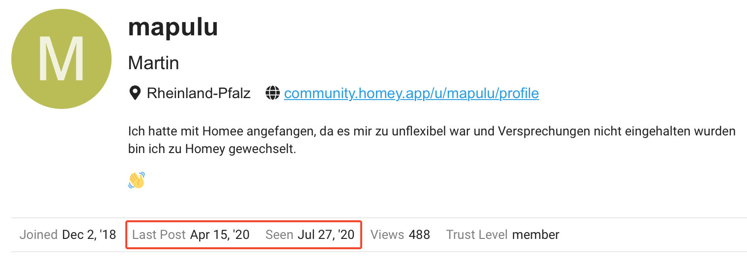

So the only way would be to contact the app developer and ask for adding the power measurement function. Probably this will not be successful, as the app developer has not been active for 2 years.
