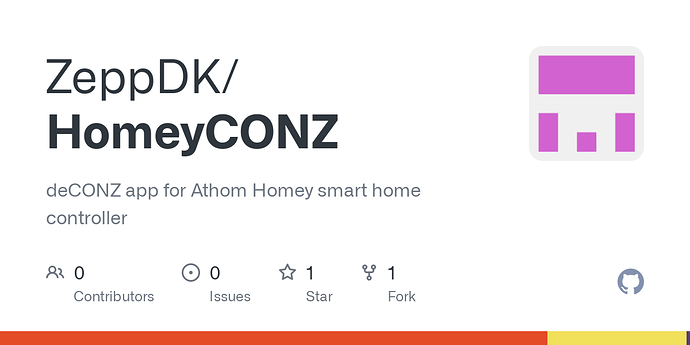

I found this, not sure but it seems to be 1.29.3 now maintained by Sepp Malec and IB Tomsen ?
There is an article here in Danish (not my strong point!):
oh wow, thats cool! My Danish is pretty bad too. Google translate does a nice job though. There is not much information, not much more than we already know, I guess. They indeed seem to have incremented the version number to .3.
I just don’t know if they took the 1.27.2 release and changed the version number, or if they actually got the 1.29.2 release and improved from there, either way, It is nice to see someone picking up the development. Hopefully they’ll add it to ‘a’ store. I guess they just started to build upon 1.27.2. Which obviously is better than nothing.
It’s based on 1.27.2: Update app.json · ZeppDK/HomeyCONZ@a8f03df · GitHub
And the parent(s) tells the rest.
