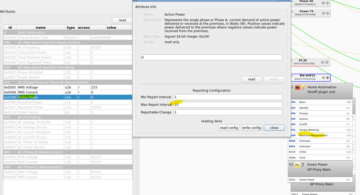

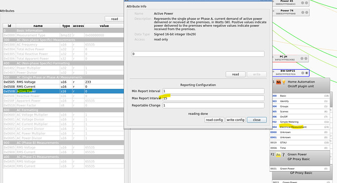

I changed the reporting interval for the following configuration parameters:
  • RMS Voltage
  • RMS Current
  • Active Power
I changed this in the GUI of deConz:
Now it reports back in a few seconds. Really happy now!
BTW this is for the BW-SHP15

You can change the update frequency on the electrical measurement value from deconz for each plug, works brilliantly and it then updates every second or so! I think they will also support setting a device default in the future.
