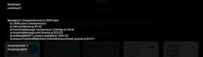

Since last night I have had the problem that the app keeps closing.
Reinstallation, PTP and new registration at Phoscon did not bring any improvement.
