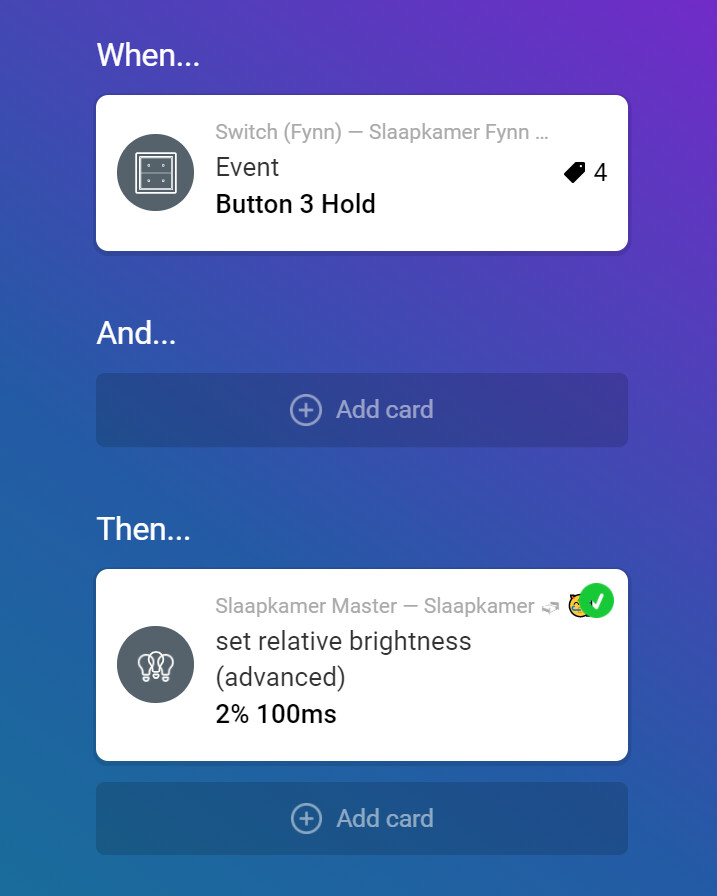

Different question, is there a way to create something like Fibaro does. Continuously press one button to dim from 0 to 100 or the other way around. How does one create something like that with a flow? I’m using Opple switches.
I tried doing it like this, see picture, but doesn’t do what I thought it would, it doesn’t loop through the brightness
I am not sure if this is supported by DeConz, I’ll need to investigate on that. What you could try is to first set the color, then set the flashing. If this works I could create a card that combines the two, but if it does not work I cannot really help you there.
Regarding your flow: this one looks good to me, the question is if the “hold” event gets emitted multiple times. For example I do exactly this with my hue dimmer switches and it works pretty fine. Can you confirm that the hold event gets emitted multiple times while you’re holding the button?

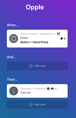

I have to look at this for a while. I have some other issues with the Opple as well. Turning off / on a room seems to turn on / off ALL zigbee lights. I’m not getting it. What is wrong with this flow:
What is button 1 on the opple. I thought it would number from left up = 1, right up = 2, left down = 3 and 4 = right bottom. When I enable the flow above it turns on ALL lights on the right upper button. Are these hardcoded? Because the left upper button turns them all off when not having a flow attached.
In regards to the previous flow, holding the button doesn’t increase the lights, it does when I re-hold it…

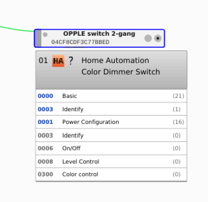

@MadMonkey in regards to the opple I think i’m running into a bug. I de-paired the opples with deconz and paired with homey. They work as expected. Paired one back to deconz and got the same issue again. button 1 turns everything off and button 2 turns everything on. With everything I mean every zigbee related device paired to deconz (powerplugs and lights).
That’s what the Opple switches seem to be doing, see also this comment. There’s also a workaround: https://github.com/dresden-elektronik/deconz-rest-plugin/issues/2061#issuecomment-579528341
And it’s being suggested here that repeated pairing may fix it.
Wow, lot’s of problems there, didn’t experience this in my previous install with the Opples going strong… some of the solutions aren’t working … i’ll read through the thread, tnx!
So… no solution for me. It keeps only showing the following:
Where it, according to the github threads, should be showing a lot more. Some suggested to keep the C button pressed for at least 13 seconds during pairing. Others suggest to keep resetting the node if the other clusters don’t show up, nothing works. I think i’ve tried resetting the node hundred times now. Nothing seems to work.
Is er niet een manier om hem handmatig aan te melden bij een extra cluster? @robertklep volgens mij gaf jij aan dit ook gedaan te hebben bij de deur/window sensor van de Lidl, toch?
I’ve got it working now. Together with the update to support the Opple events and the pressing of the C button after pairing. The latter seems to do the trick.
