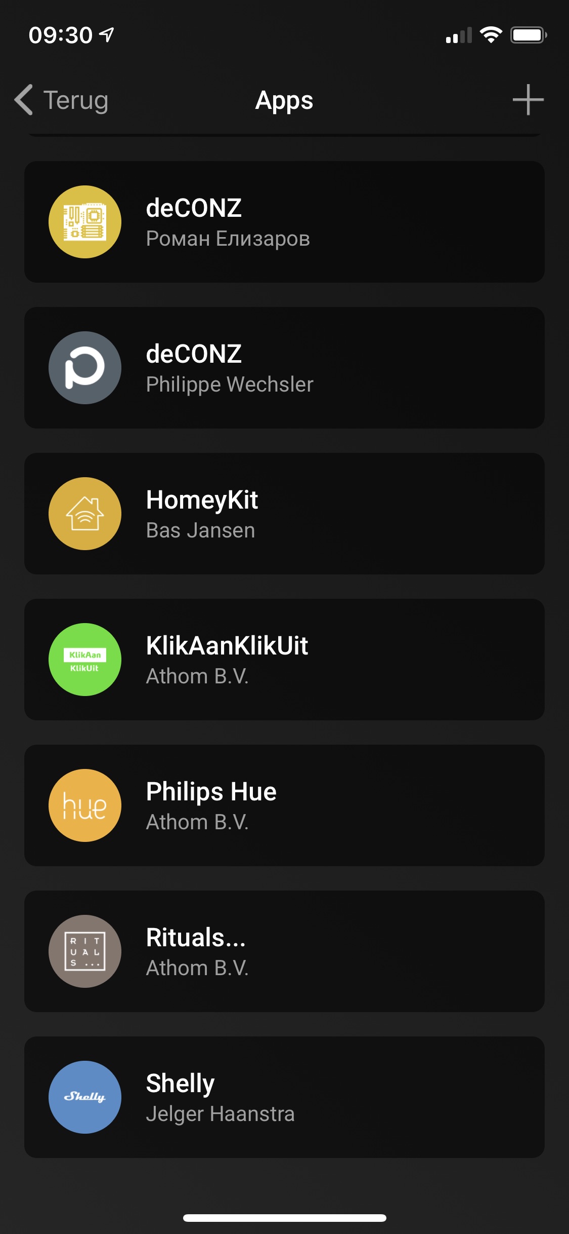

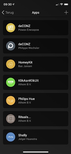

Hi Robert,
As SilverApe mentioned, I used the unofficial deCONZ app on Homey. See screenshot.
When you select this app in Homey there is an option to remove the unofficial app, but I wonder if this removes all the settings that have been installed via cli.
For Homey, these are two different apps, so you will lose settings/devices anyway if you exchange one app for the other.
I know. That’s not a problem for me.
The uninstall will remove the correct files from the unofficial app? Or uninstall from cli is better?
I don’t even think you can uninstall an app from the CLI :slight_smile:
