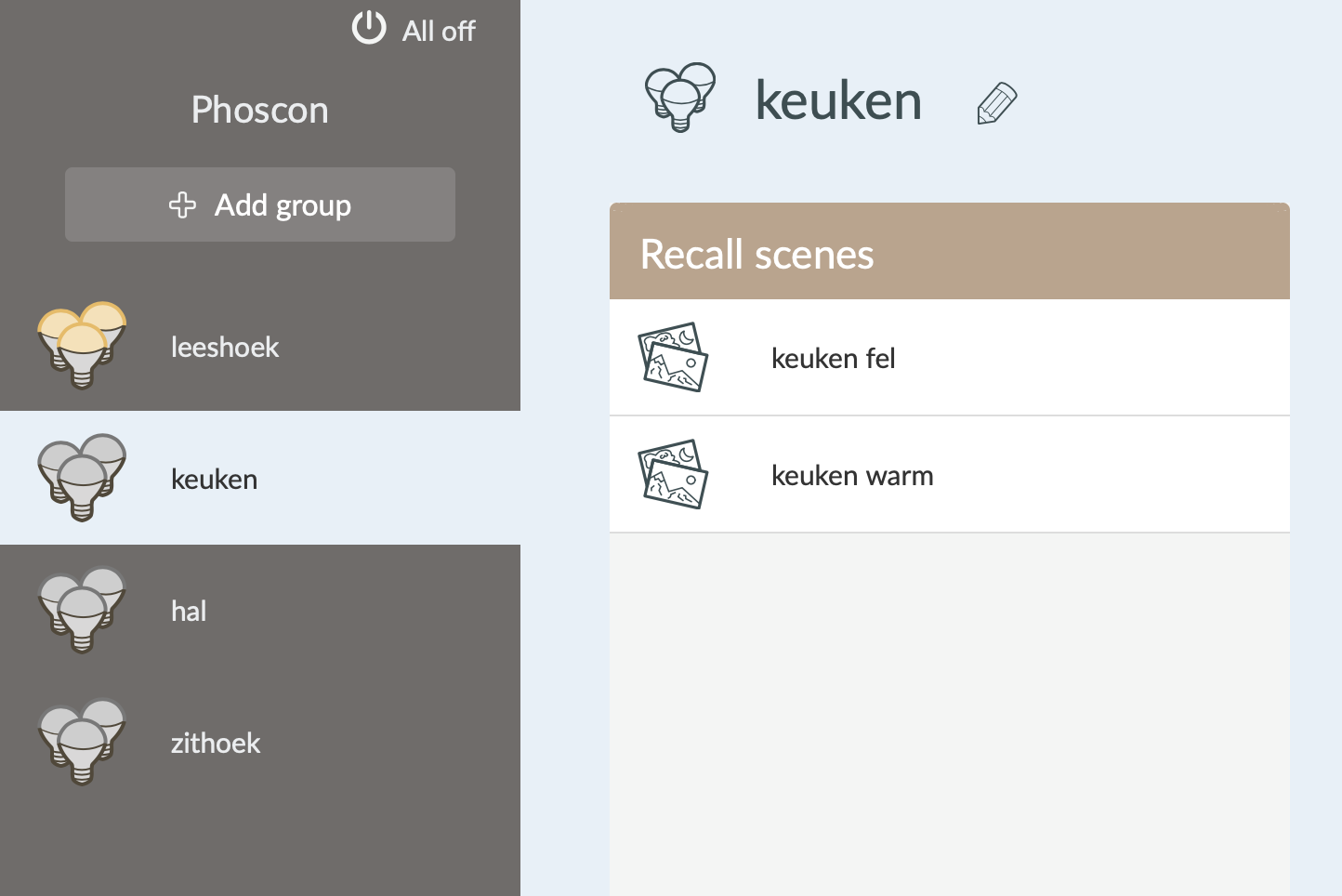

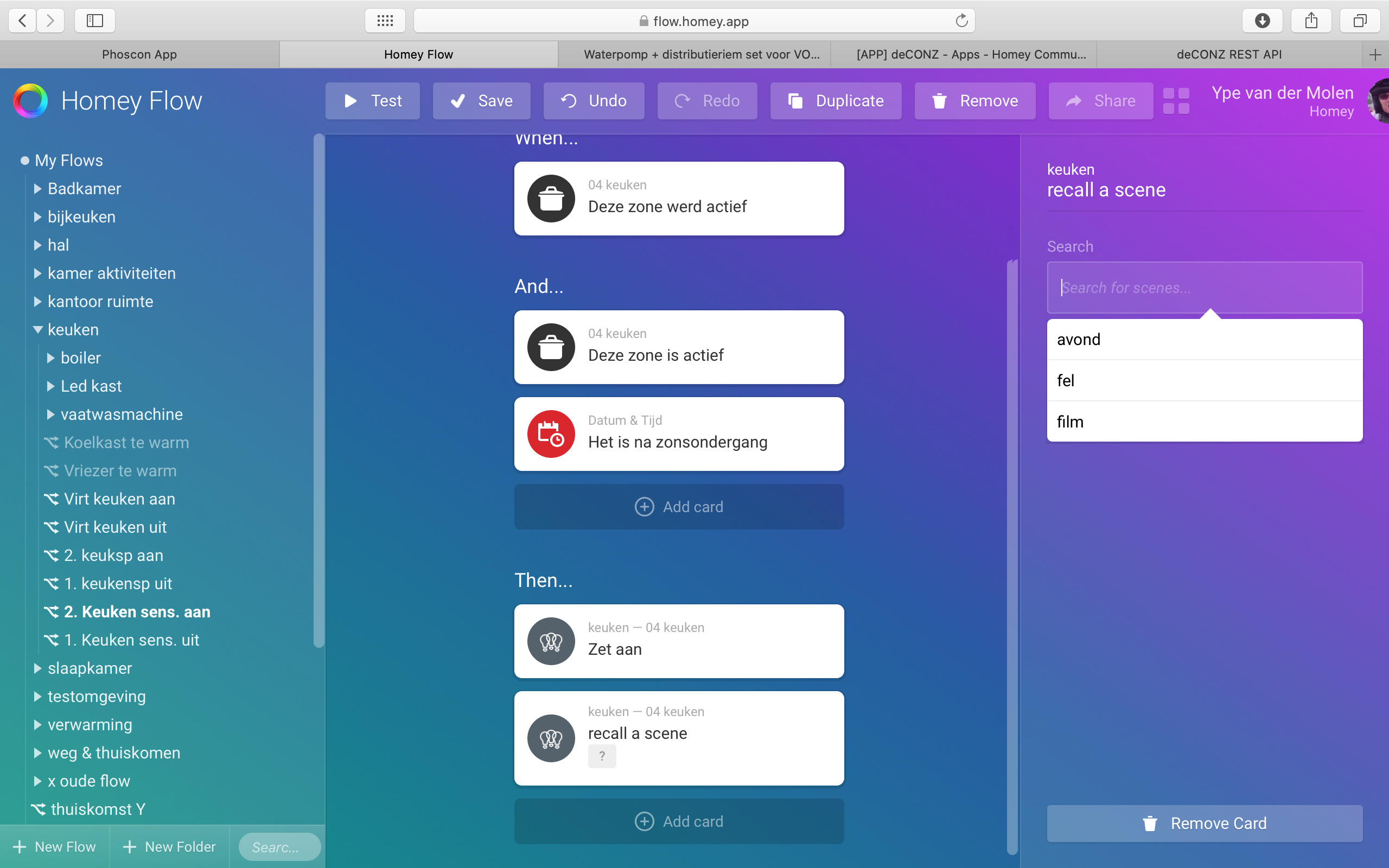

i can not get te right scene for my kitchen connected. In phoscon i created differend scenes for different rooms. For my kitchen i want to turn the lights on with a sensor when in homey the kitchen gets active. As you discribed i added a card of group kitchen on, card recal a scene, but when i try to ad the scen “lights warm” in the kitchen only the scenes from my living room are shown. What is wrong??
Hey @Ype
Are you sure that in phoscon the scenes are created as child of the kitchen group?
as you can see they are child of the kintchen group
Let me investigate, maybe I’ll need a little help from you :smile:
oke
I think i know a liitle bit what the problem is. As soon as you change annything in conbee, a light change or anything, i think you have to remove the Group and re-add it again an use it for Your flows in homey, at least i think it is. Every time i edit a scène in can be re-add. Exept zithoek witch keeps can be re-added
I could reproduce the case and it seems it is not in deconz and not with my app but rather with homey itself…I am sure I’ll be able to provide a workaround but I need to dig a bit deeper
