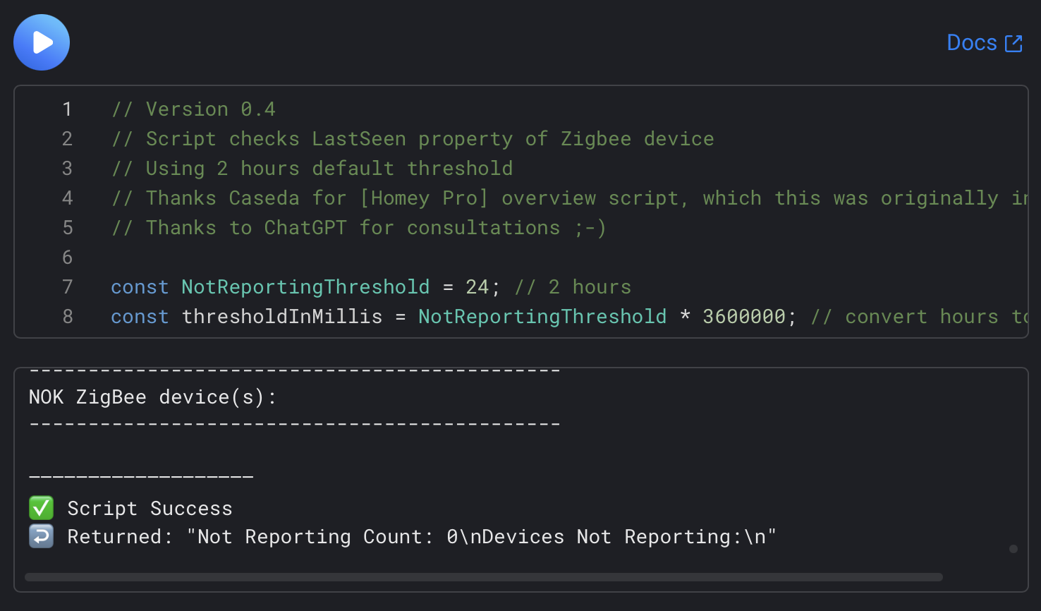

’m making a mistake somewhere. I’m using version 0.4 but for all devices, I get: NaN-NaN-NaN, NaN:NaN:NaN. Invalid value for time?
Am I doing something wrong…? Additionally, the script now indicates that all sensors are OK. But there’s one sensor that hasn’t responded for 3 days. (that’s why I want to use this script)
Did you just copy paste the script and run it and with log scrolled up, share the screen, eg:
alldevices
or
zigbee
Thanks for taking a look. I copied the script exactly as is. I only changed the ReportingThreshold to 24. But even without that change, I’m still getting NaN-NaN-NaN.

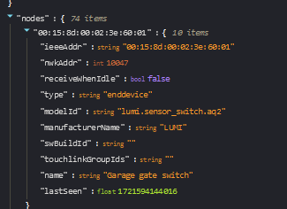

Hm, interesting, Which Homey firmware version and HomeyScript you are on ?
Can you also go to Homey Developer Tools and launch :
Homey.Zigbee.getState();
And then copy here part like this one :
dev
(if you want, obfuscate ieeeAddr)

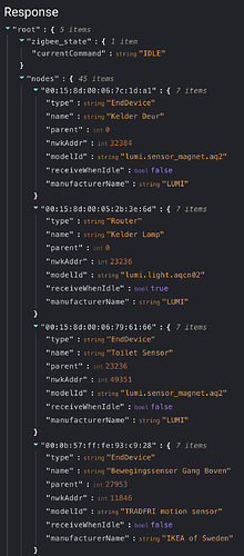

I get this error with the launch of ‘Homey.Zigbee.getState();’
Should be Homey.zigbee.getState() (lower case ‘z’)
Ah! That worked indeed.
I don’t see any “lastSeen” like in your screenshot…
Damn autocorrect, although it shouldn’t touch code blocks :woozy_face:
