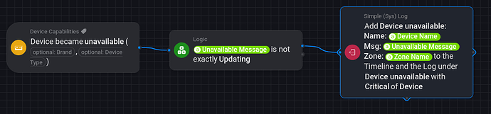

Like @Arie_J_Godschalk proposed last Januari, doesn’t this work on a Pro 2023? It’s done with this app.
Did some tests on a 2019, curious if this also works on a 2023 (which I don’t own);
I just disabled some apps here, and this is the result, only this is instant, and not after x hours of unavailability:
Thanks, I also tried the DC app, but it looks like it only triggers on devices that get really unavailable in Homey (visible on the device icon in the App), which ahappens when you stop an app for example. It does not trigger on devices that have stopped reporting in x hours, which is what happens for Zigbee end devices that get disconnected or powered zigbee devices that have power cut off. Unfortunately Homey will happlicy show such a device as if it’s fine until you try to control it.
