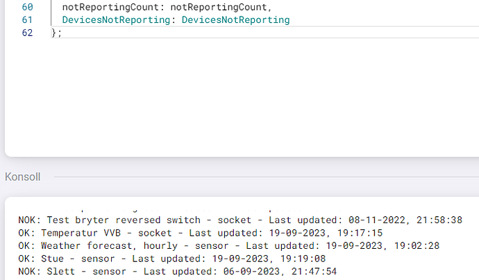

I ran your script and got this:
Is this checking all the zigbee devices, doesn’t matter what type it is?
It matters, you need to adjust conditions in the script… name and-or class (device type)

Simply take the script above and launch it - based on the output, adjust it as needed.
Eg. without modifying anything, this will give you state of temperature sensors only, which were not updated in last 0.8 hours.
By launching it from Adv. flow, you will also get Console output.
obrazek
Or if you put // in front of this :
 if (!device.name.match(/temperature/i)) continue; //
You will get all sensor|button|remote|socket|lights …
Now something happened here, very good :slight_smile:
Thank you!
