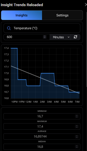

Can’t you use Insights reloaded for that?
Or maybe Device capabilities app, which shall have option to recall insight stored previously (never used though for such use case)
DC THEN
obrazek
Insights Reloaded
