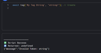

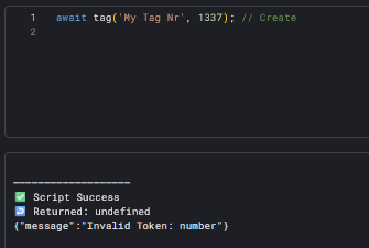

Btw even this simple example return error…
number
string
FYI - asking Athom if this is a bug or not
update it’s not a bug, script must be updated (but you can still use it just for THEN it will return the error but the variables gets updated
