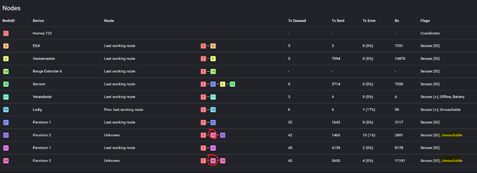

I have two z-wave devices that keeps falling off the network. They are both in a room with another z-wave device (of the same make & model) that I can reach. The strange thing is that both devices are apparently trying to route via non-existing nodes.
I can unplug them and they work for some time (1-5 hours) before they fall off again. Any ideas?

Interesting thing is: the devices that are “unreachable” do still seem to send their data to Homey. So, is there an actual issue?
In my case, one is unreachable through non existing nodes.
A few others that are unreachable are connected through a Greenwave power node. Not all nodes that are connected through that Greenwave power node are unreachable however.
All of them do send data to Homey. The one that is unreachable through non existing nodes previously was connected through that same Greenwave power node.

Do you guys see these devices working or not working?
My devices are not working when unreachable. If there were working I’d not care.
@paaland Which screen is this routing table? (I also have device which is not reachable and would like to know how my zwave network is setup)
