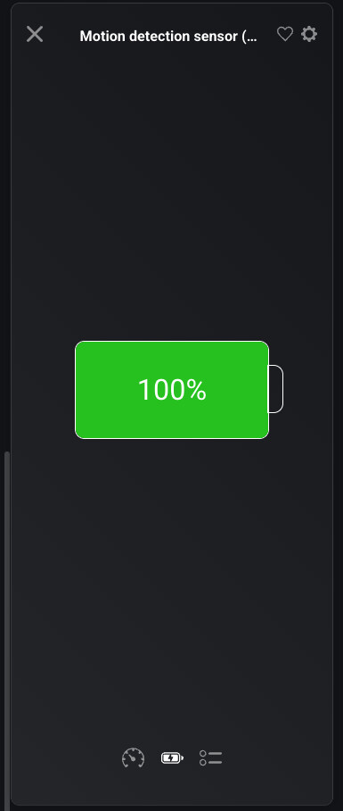

Batteries show fine too. Hoping someone else one here has these sensors too.
This is just an indicator, it says nothing about actual battery quality.
