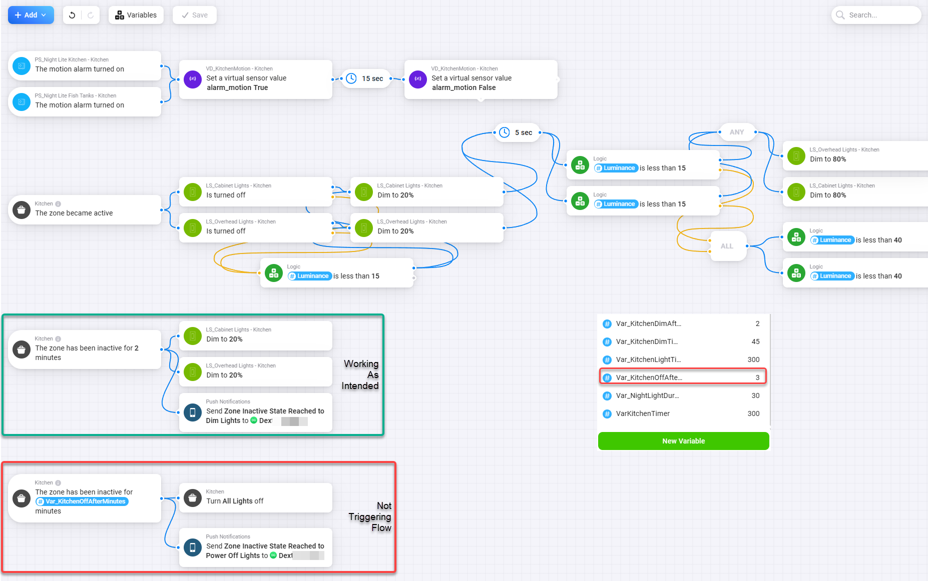

According to the Homey tutorials what I’m attempting is native functionality, but when I introduce a variable into my flow, the trigger does not work. Here is my flow example showing the variables I’m using. The trigger with the static value in zone inactive after x works, the one using the number variable does not trigger, however.
It works with a manual test, but it’s not evaluating on its own. Is there a log of some sort that allows me to see each step and why, for example, the variable is causing an error (which does not trigger an error)? Otherwise, is there an official known issues log maintained by homey that lists which “native” features are broken with Homey Early 23 so I can avoid using them?

In most triggercards, you can’t use a variable as value, but as you’ve noticed, there’s no warning and the card can be saved.

Not to my knowledge. You happen to have used an invalid input method.
Pls write to Athom support why there’s no warning / why you can save the card (homey.app/support).

I have also been left in the dark, after the sensors have “said” "zone inactive"and i do enter the room again. Solved it by adding “Zone active” card after the “zone inactive in xxminutes”. Never been left in the dark since that. I guess the timer starts at first “zone inactive” report, and again at next, and so on.
