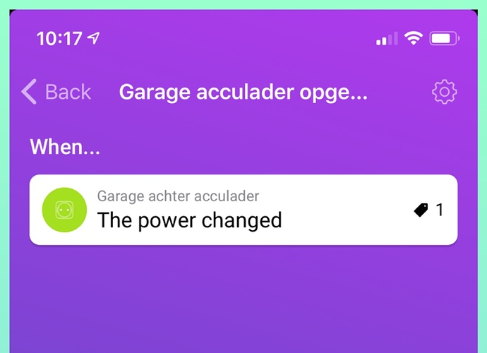

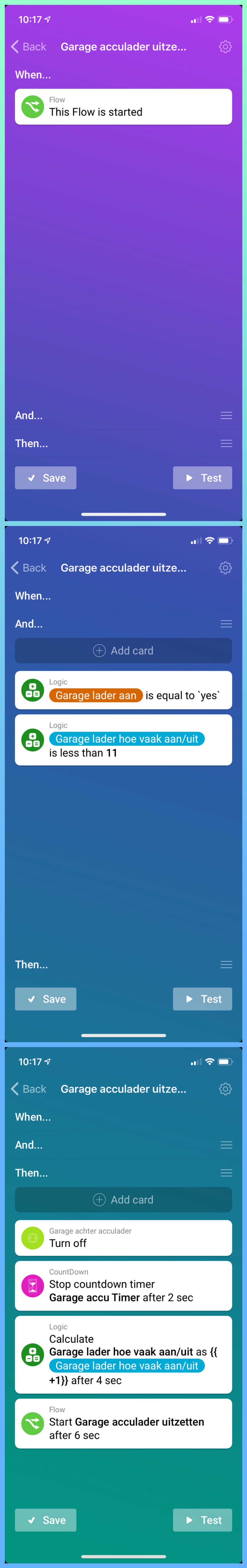

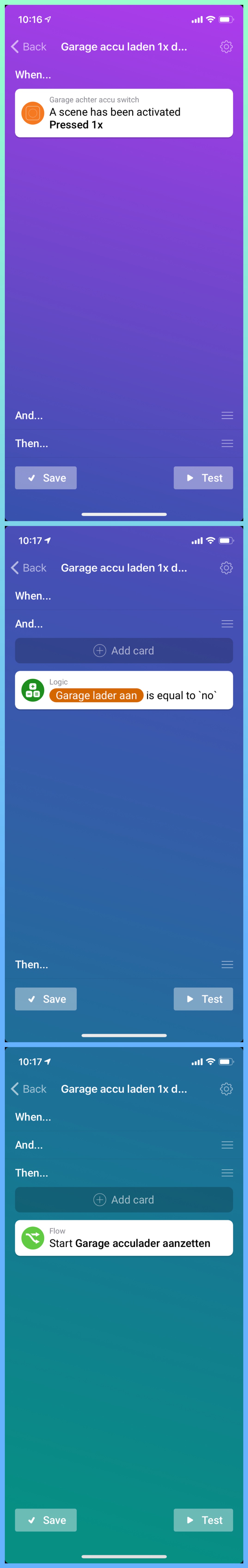

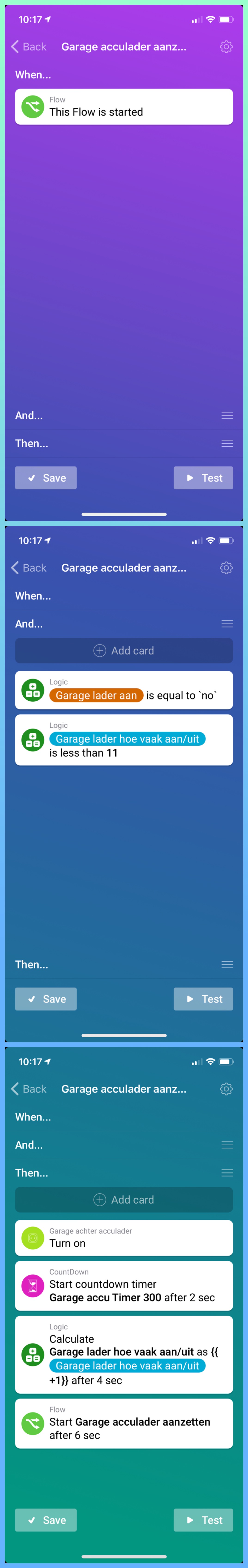

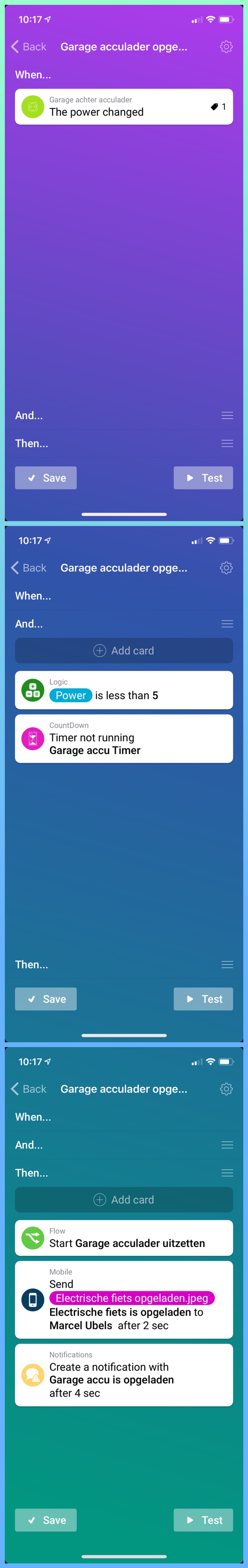

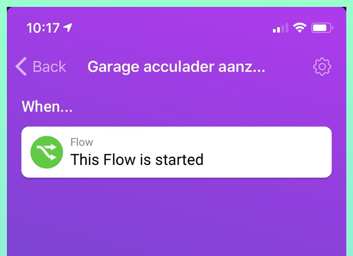

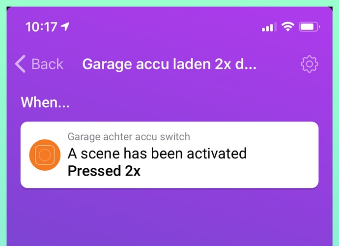

I also have some zigbee problems. Biggest problem is the WAF. So in this case I made a few flows, so whatever happens, it will work in the end. In this case I have a electrical bike. Sometimes I have to charge its battery. I had a zigbee powerplug from Innr and a Aqara button. Made some flows to push the button and it starts charging. When the battery is full, the powerplug goes off. Unfortunately you sometimes have to push the button more than once. This is killing for the WAF. I made some flows, so if you push the button once it will try again and again untill is starts, for security reasons, I added a maximum of 10 trials. That way it loops not to often. Hope this helps some!
