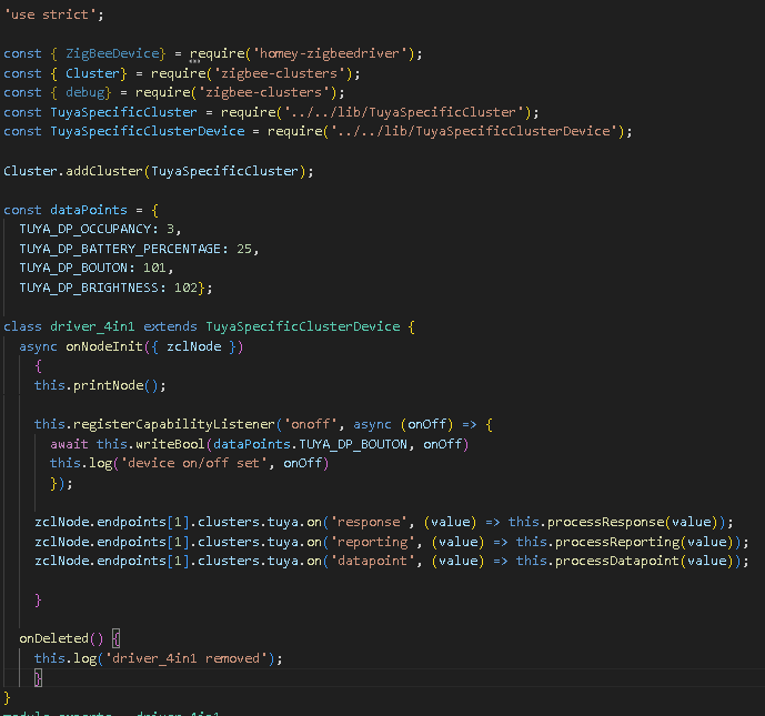

I have something similar to code.
But I am not successful :
I write :
That seems correct, but I got this message when I press the button:
What could I do ?
Regards
