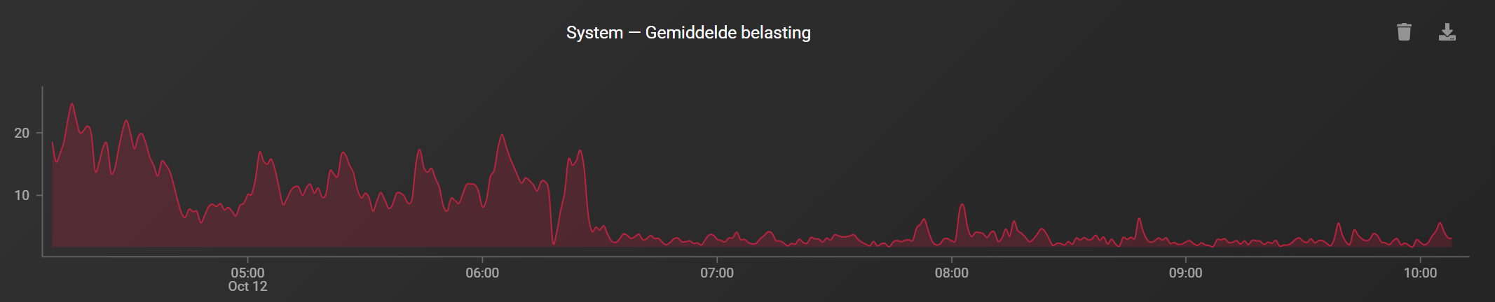

the load on my homey has increased so much I can’t do anything with it anymore. My homey reboots at 6.15 am. But with a load of ~15 - 20 it constantly tells me it’s offline. Motion sensors don’t respond, or very late (~30 / 45 sec delay). And there is no reason it should consume so much load at 5 am. It doesn’t do anything at that moment in time (maybe backup, but that shouldn’t take so long).
And the only thing changed is moving from deCONZ to native zigbee (and thus installing IKEA, Philips and Aqara apps).
