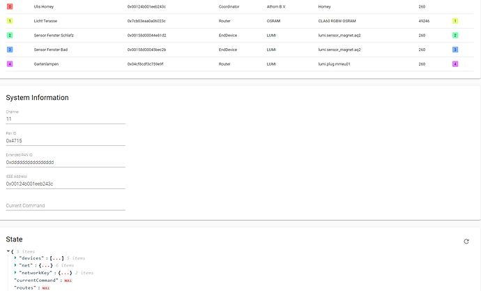

Sorry to bring this older topic up again but I am also trying to create a Zigbee Mesh to allow senors further away to communicate to Homey.
When I look to the Zigbee Developer page I see not even any route. Just the device numbers.
Already refreshed the page to try to get the “generateMap” Command but it wont appear.
Anyone any idea how to get the routing info ?
Wait. It may take quite a while before that page shows routes.
Thanks. Yes I have read that here already, also to unpower Homey for a while and reconnect but it did not help. I have this status since Friday last week.
I thought it should show at least 0-1 and 0-2 etc where 0 is Homey. But here it shows just the Node-ID in the route column.

I mean: load the page, and leave it open for a while (say 20 minutes).
Thanks, but it deoes not help either.
