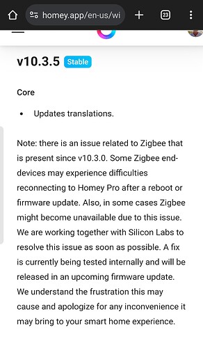

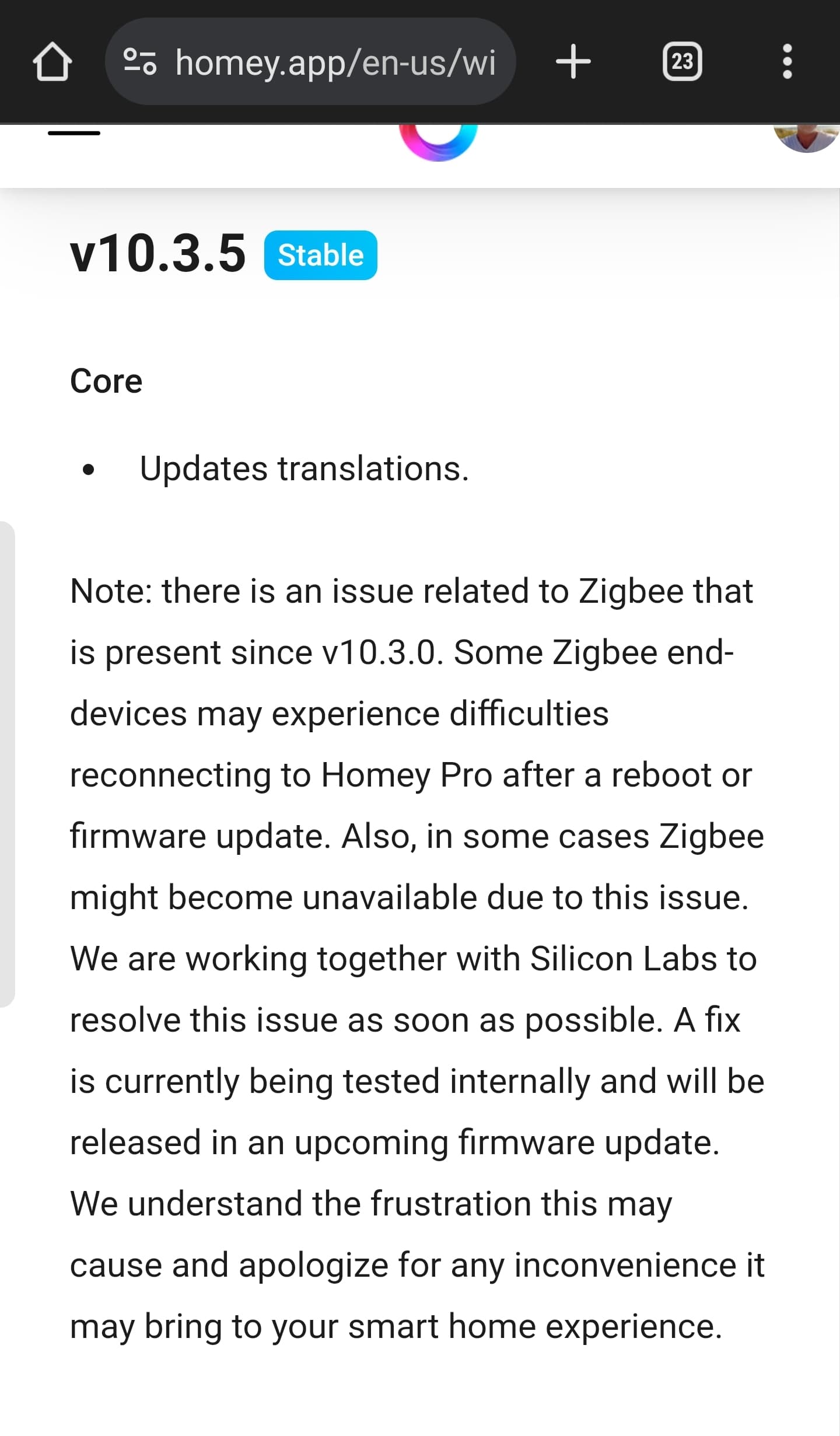

Also note this statement below from the firmware overview. Seems not related to your experiences, but it’s not yet 100% fine imho
