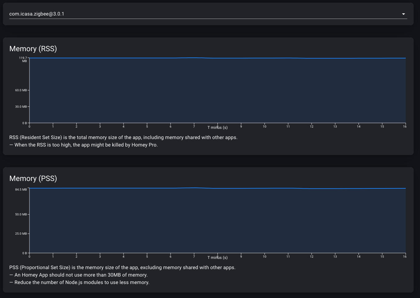

What the CPU does and what do you see in the insights for this app - CPU and mem ?

RSS 72.4MB
PSS well above 30mb, now 37mb
CPU flatlines on zero and shoots to ±10% with any interaction
After i restart the specific app from Icasa the PSS lowers to ±20mb but gradually goes up. Even after deleting half of the Icasa devices still around the same level
Yeah, I mean Insights…graphs, eg. for past hour or so… but based on explanation, it’s stable
It’s OKay
