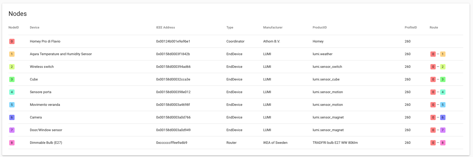

Thank you Robert, if i have understand you say to install before the tradfri bulb instead ending device , but now for example, i’ve installed the bulb After a lot of sensors, do you think the system not work proprelly , how can i see if All Is meshed?
If you add end devices (like sensors), you can run into the limit of about 20 devices that Homey has. If you add router devices (like lightbulbs), the sensors will (hopefully) connect to those instead of to Homey directly.
The mesh is (somewhat) shown here: https://developer.athom.com/tools/zigbee (it may take a while after opening that page for the routing to be shown properly)

so if I’ ve understand all device are connect to homey and no one to router ikea , right?, but if i buy a new sensor and I paring it to homey, near the router ikea, the new device hopefully will connect to homey but via ikea bulb, right? thank you
Yes, it looks like the devices are connected to Homey directly. You cannot force devices to use one router or the other (nor can Homey), that’s why it makes more sense to add router devices first, let them build a mesh, and hope that sensors will use a mesh router instead of Homey (more routers means more choice for the sensor device to connect to one).
