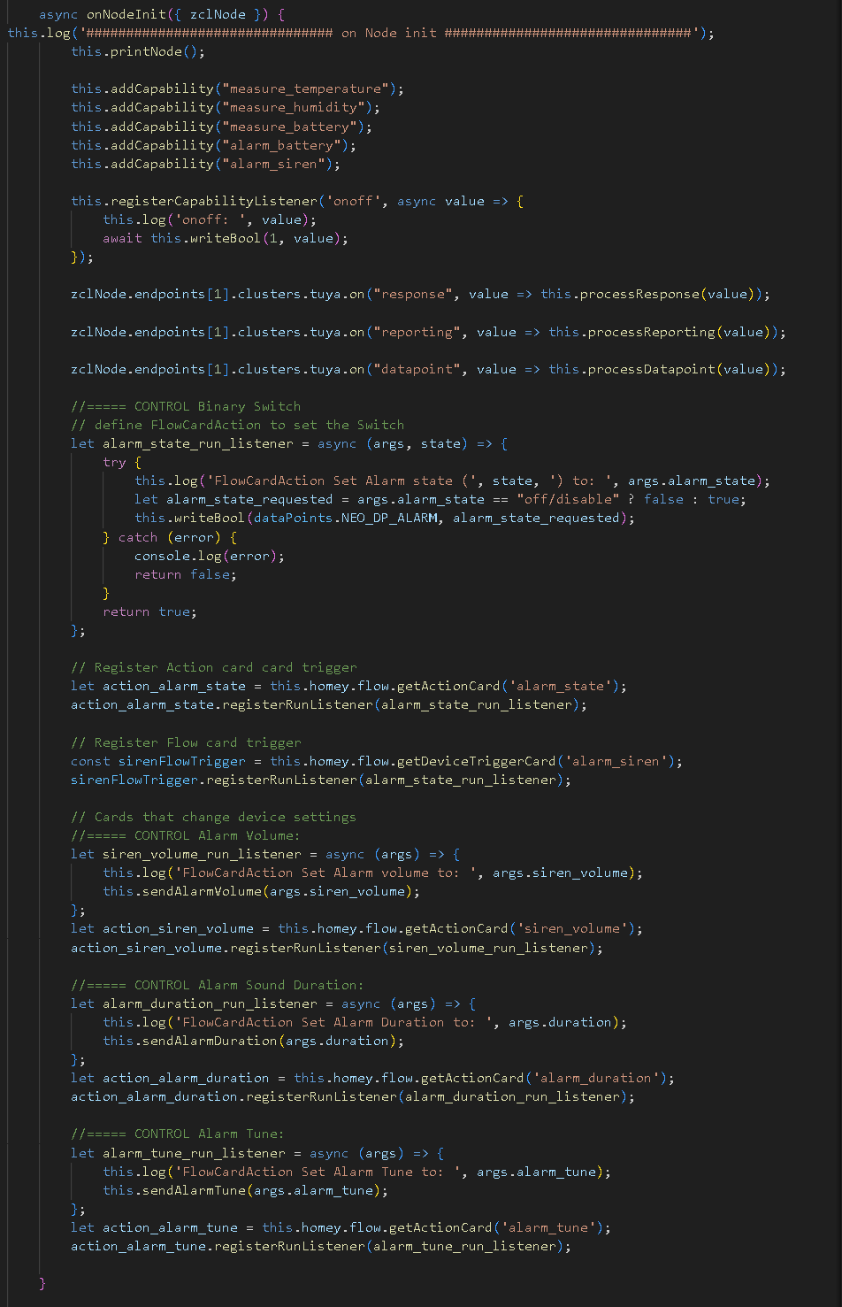

A few things are working : I can pair the siren, I can play with the cards : data seems sent to the device but I was unable to make the siren sounding …
Nothing appears on the screen of my phone unless I add :
this.setCapabilityValue(‘measure_temperature’, 22) within device.js.

That’s what I have in this section :
I don’t see any attribute reporting code.
So, I have to add them ??

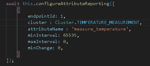

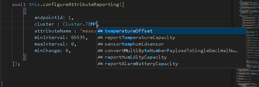

But, when I try to write :
I can’t, because TEMPERATURE_MEASUREMENT is not known :slight_smile:
These are my statements :
WXhat I’m doing wrong ?

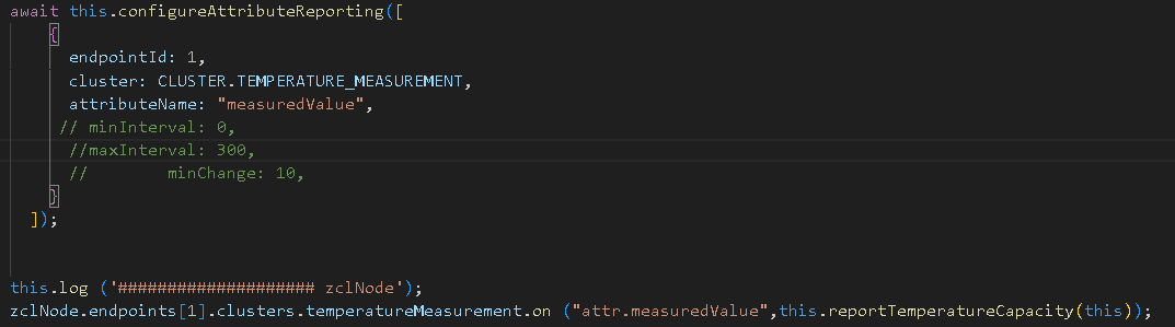

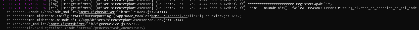

Regarding the attribute code, I write this :
It was OK for the first statement, but I got an error on the scond :
I am perplex as the cluster exists ! It was Ok for the first statement …
