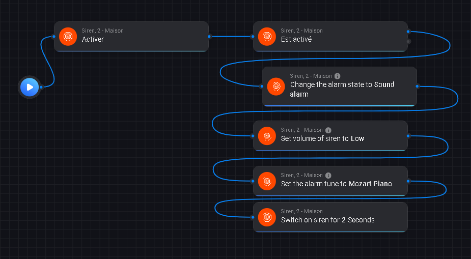

I wrote some flows and the orders were sent to the device.
Activation (onoff) seems working.
But : there are no values on the device screen (temperature, humidity and siren state)
I could not be able to get any sound from the siren …

Thanks for the links you posted. With the help of the driver here I managed to get the siren to start working:
I can now change the volume, tune and toggle the siren on/off. Latest code in github.

The magic change is that the alarm (onoff) capability is on DP 13. I will finish up the changes to the driver tonight/tomorrow to get everything tidied up and then will see if i can create a pull request to get this merged into the community Tuya app.

I have installed this new driver with CLI on my HOMEY and, now, my siren can sound !!
Thanks to Johan Rossouw who have done this new driver !!
