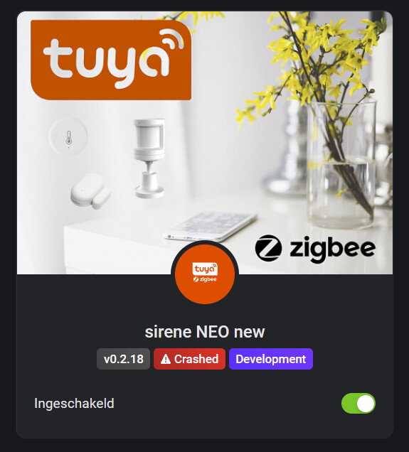

Okay, installed it using the CLI,
It seems to be installed but it keeps crashing immediately:
Tried restarting several times, tried to install the sirene as a unknown Zigbee device first, restarted Homey, and tried using it without the Tuya app (maybe some interference). No luck, keeps crashing immediately.

Run the app using homey app run --remote, that way you’ll see any crash logs when they happen.
Thanks Robert,
This is the crashlog:
CreateClientError: Cannot find module 'zigbee-clusters'

⚠ The app has crashed.
Exit Code: 1, Exit Signal: null
Apparently it is missing the “zigbee-clusters” module :thinking:
Should I install it like this ?:
You need to run npm install before running/installing the app.
Thanks again Robert… I’m a bit further. I can run the app remotely without crashing. I can add the Zigbee Siren, but when I try to activate it (in with the UI button, or in a flow) I get the error:
“Could not get device by id”
