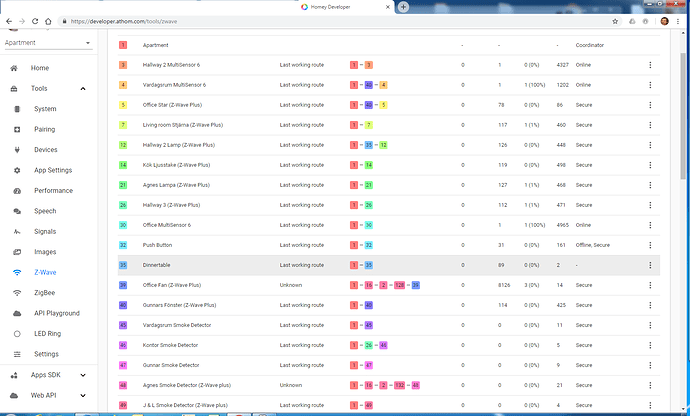

Why do they choose this path that is not there.
39: 1-16-2-128-39
Where 16, 2 and 128 do not exist
Similar problems with 48:
See attached picture.
I’ve run “heal”
I have tried with a delete 39: and 48: = OK and then added again = OK
It will end up here after a couple of days. They are only 2.5 meters away from another Z-Wave sensor of the same type that works.
What more is there to do?
If you see the word in front of it: unknown, which means “i don’t know”, it is clearly saying that that isn’t the route last taken.
Try healing all other powered devices, not just the devices that are “unknown routing”, best to start from nearby homey, and then work your way outwards.
