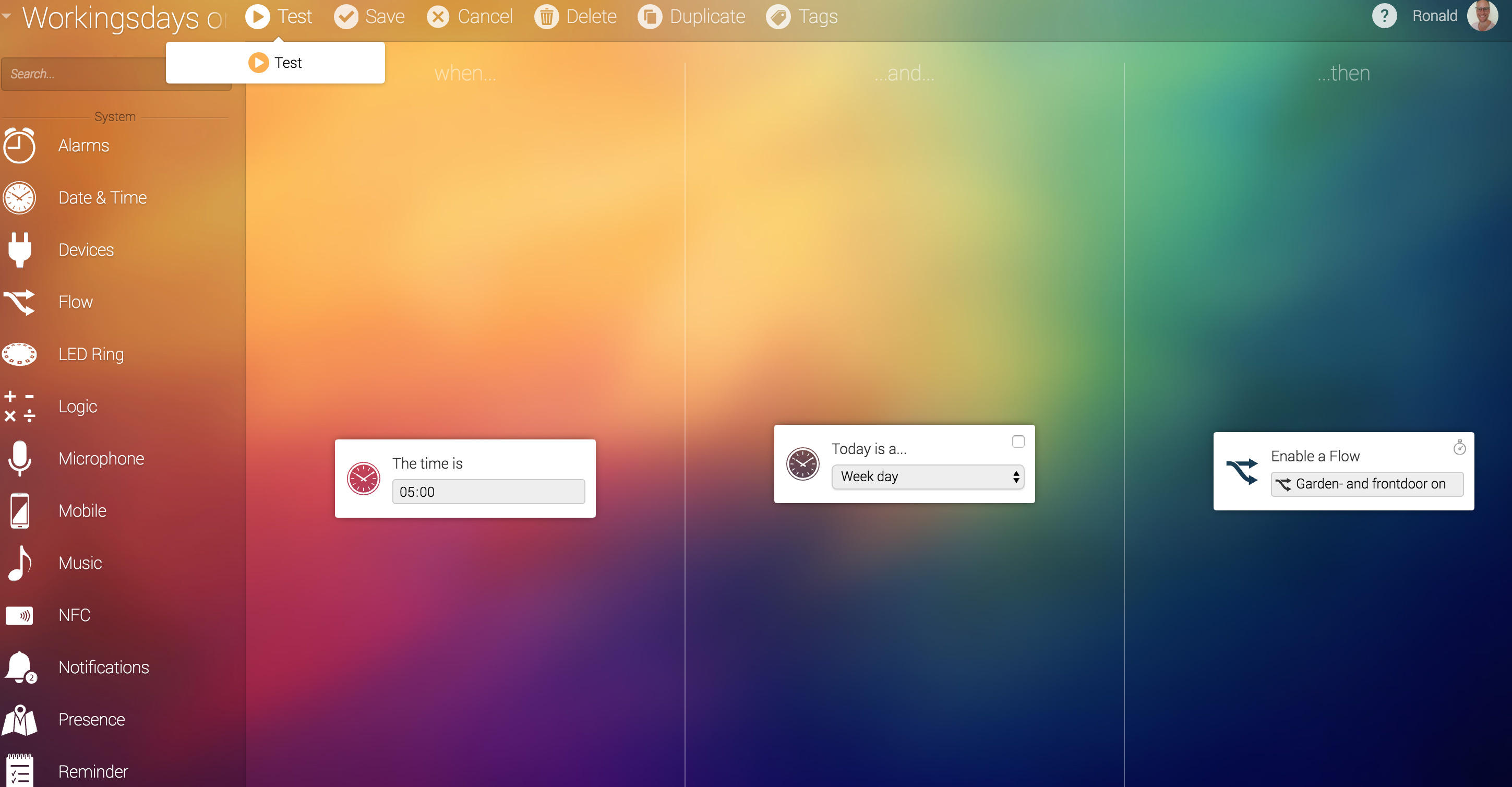

I do have flows that enable another flow. See screenshots. The screenshots from my earlier reply show the rest. The flow ‘Garden and frontdoor on/off’ work fine. This flow gets triggered by the flows ‘weekend’ and ‘workingdays on/off’. This is where the next issue arises.
I can’t get the test ‘workingdays’ or ‘weekend’ getting the light on or off. Am I doing something wrong here?
In short: a single on/off flow works, but enabling the on/off flow via another flow not.
Thanks!
18|540x438
I think you are using the wrong action (then) in your flow.
You xpcan do different actions with flows:
Enable/ disable them: disable means they will never be triggered anymore. Enable means they are active
Start a flow: triggers the execution of a flow.
You are using enable while I think you want to start a flow.

But in the dropdown menu of START flows, I cannot find the flows I need. That is why I use the enable function. And the disable if only to turn off the lights. Do you know why there are no flows in the start flow dropdown?
The flow has to have the trigger “this flow is started”
