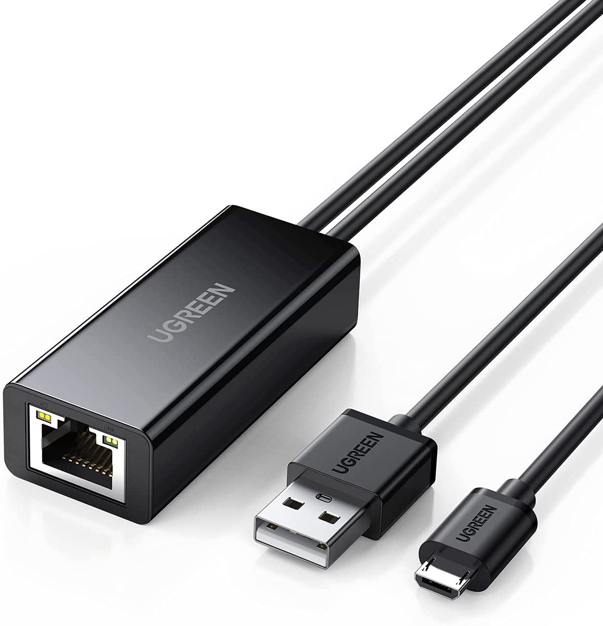

indeed this one + Micro USB to Mini USB Adapter F/M - Micro USB Cables | Belgium micro to mini usb adapter.
The Ugreen Y cable with LAN adapter works like a charm and 100% stable on my chromecast it is a 100% professional solution supported by Google.
If Google supports and agrees with it then it is a good solution for Homey too. Itwould bring homey to the big players market instead of the hobbyiest’s one.
