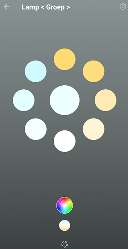

When setting a colour through a flow only the following pallet is shown
When going to the same device group (as used above for setting the flow) and manually changing the colour the following pallet is shown as well. Which i can’t seem to find when setting the colour within the flow.

The first screenshots sets the colour.
The second screenshots sets the colour temperature right?
When i go to “set a temperature” within a flow i’m presented with a percentage slider.
What i don’t get is why the i can’t use the same presets (or colour temperature pallet shown in screenshots 2) which are provided when i’m setting the “colour temperature” from the devices tab.

the white colors on the GUI aren’t representative at all, the blue ish color doesn’t always get as blue as the GUI states, the same goes for the warm white color, so saying that the GUI is better is relative.
