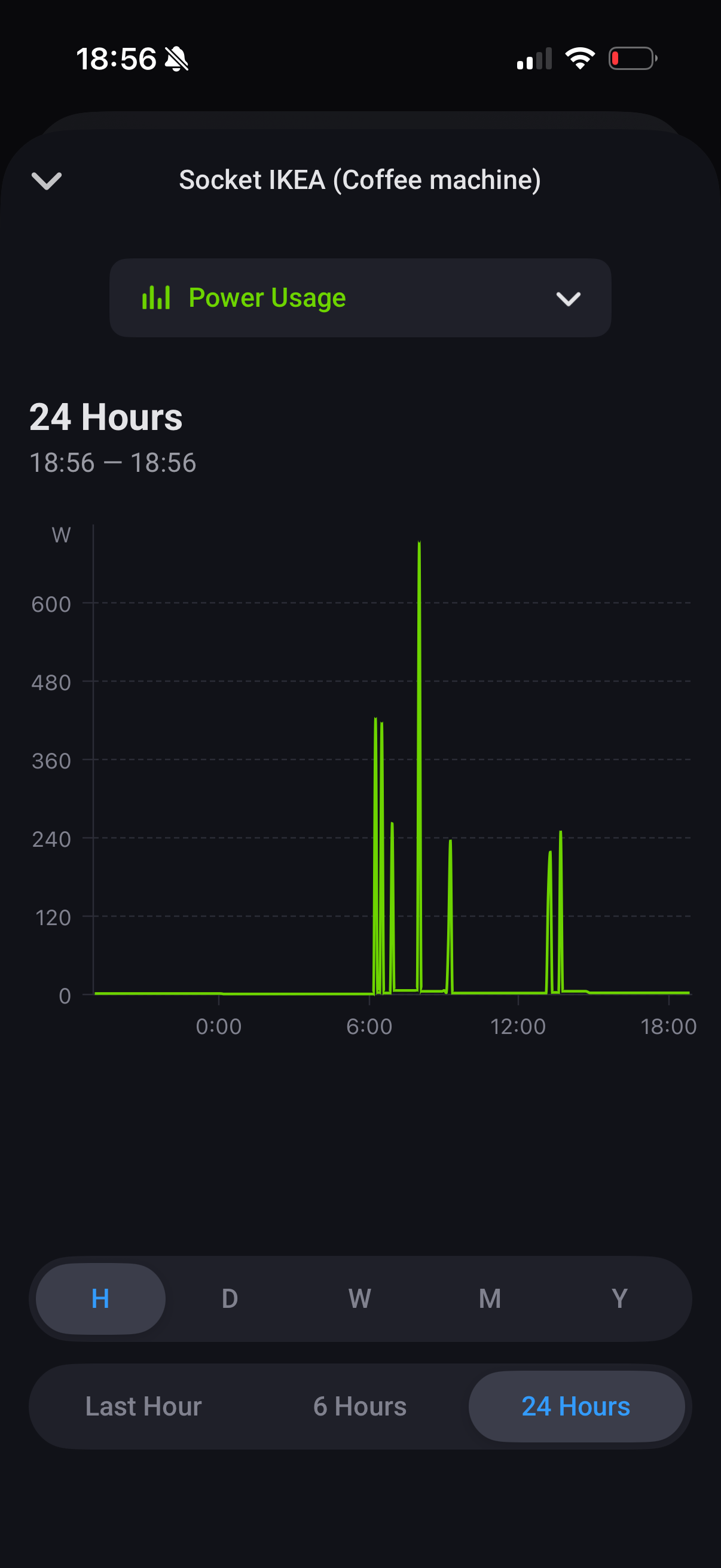

I am currently new to Homey and connected my socket via Zigbee2MQTT. I am getting funny results when it comes to Power consumption between Home Assistant and Homey. Does anybody have an explanation ?
The Energy seems to be correct though (kWh) only the Power is incorrect. It looks like Homey is not reporting the peaks in the graph because if I read the metrics like from Homey I can see the peak to 1600W.
Homey starts averaging values very quickly, which will remove transients peaks. Home Assistant will keep the actual data for multiple days (which is configurable, with the default being 10 days) and only then start to average.
thank you for your answer Robert. How can I determine then at what level of Power goes my device if I am not in front of the screen and wants to read graphs?
You can’t with Homey, because it simply removes the actual data very quickly and replaces it with the averaged values.
The only way will probably be to use an app to export your data to an external database and use an external visualiser (like Grafana) to show proper charts. Or keep on using Home Assistant.
