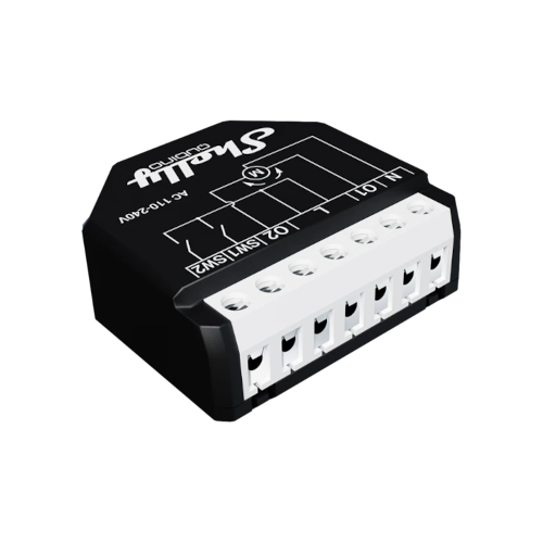

To control them I’m Currently using some of these:
However, they are not working with Homey, and as the Tuya Zigbee app seems to be kind of dead, I do not think they will be added shortly. (requested the device already some weeks a go) they are now connected with Home assistant using a conbee stick, but the connection is really bad and I have them now on a smart socket to restart them so now and then to keep them alive. I also do not prefer to use 2 Zigbee networks, so working with Homey directly will be a lot better.
My question is; are there similar controllers which actually do work with Homey? I didn’t find it yet. I like to use a Zigbee device (or WiFi), and not too expensive. :grimacing:

  • _TZ3210_dwytrmda / TS130F (GIRIER) (Test version only)
  • _TZ3210_ol1uhvza / TS130F (Lonsonho) (Test version only)
Above devices are in the test version of the Tuya Zigbee App. It might be possible to add your device (Device Request - [Mini Curtain Switch Module] - [Moes] / [TS130F, _TZ3210_zana8d08] · Issue #1222 · JohanBendz/com.tuya.zigbee · GitHub) (?)
by just adding the device-id’s to the app. This method is discussed in the thread [APP][Pro] Tuya Zigbee App .
Thanks for your help.
I know there are a couple of similar devices already supported and it should be not too hard to add my device as well. I only have no idea how to do it myself. Do you have any idea? Do you know if there is some documentation about how to add stuff yourself and how to install that to my Homey?
I’m sorry, I don’t know how to do it myself, but I remember having read it somewhere in the mentioned topic. If I would like to add a device myself to the app, I would scroll through the topic to find the described method. It’s adding some text to some files, and then installing them manually on homey, as I recall.
