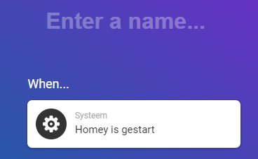

About the flow:
the card in your printscreen is ‘the energy has changed’. This is Homey energy usage. Why don’t you use Homey has started under system? (Homey a commence in French i think)
Another option is to save the 19 degrees in a tag:
