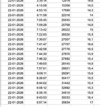

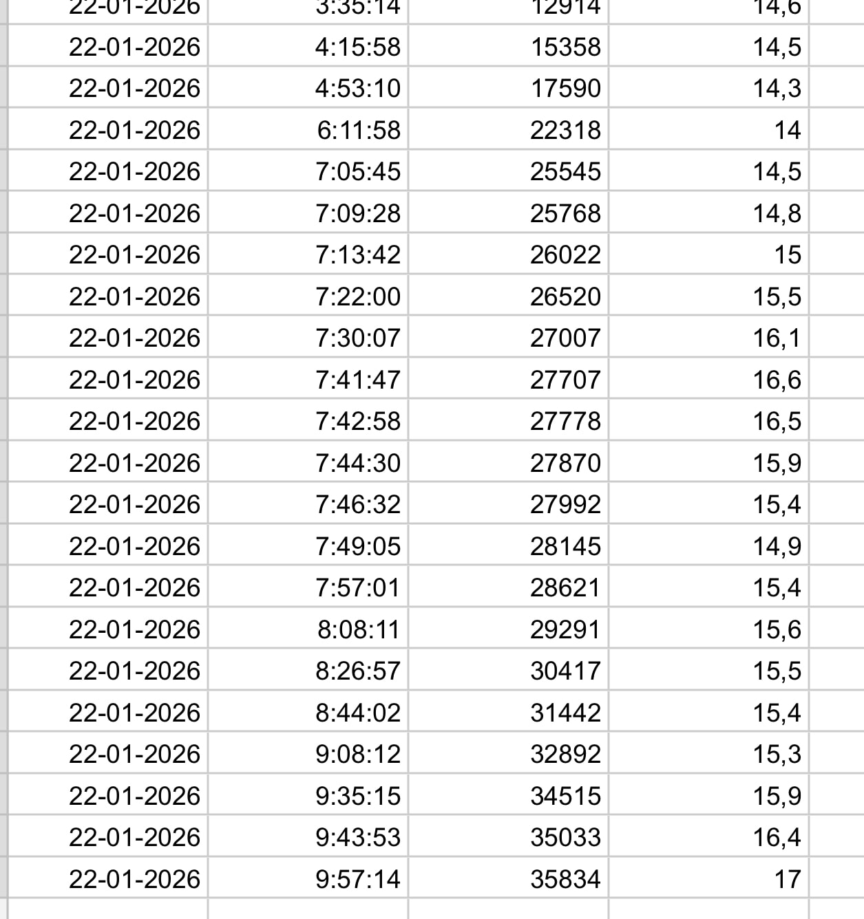

The sheet below is logging every time Homey is updated by my temp-sensor.
At 6:11 this was almost one hour between updates.
