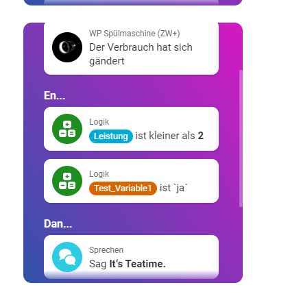

It’s in German language, sorry.
The way of realisation may depend on the behaviour of the kettle/water cooker and on the performance values. It may make sense to look at the performance curve in Insights.
Maybe you have to change the 50 Watt in the first and the 2 Watt in the second flow, but I guess it will work:

Hi Wim,
did you tried it? Because only when the consumption is higher than 50 W (in mine example) the variable Test_Variable1 is set to true.
This must be fulfilled that Homey says „It’s Teatime“. After 65 sec. the variable is set to false again.
So Homey only say „It’s Teatime“ if the variable Test_Variable1 is set to true.
And the smart watch can’t set the variable to true because it’s consumption is not higher than 50 W.
So it should work.
Additional you can use a time period or the „awake/sleeping“ option.
In the And… section you can ad „Wim is awake“. So the flow is only triggered when you are awake. But therefore you have to set „Wim is awake/sleeping“. This could be done manual or automatically.
And/or
In the And… section you can set a time, for example „Between 6:00 - 22:00 o’clock“. Between 22:00 - 6:00 o’clock the flow will not be triggered.

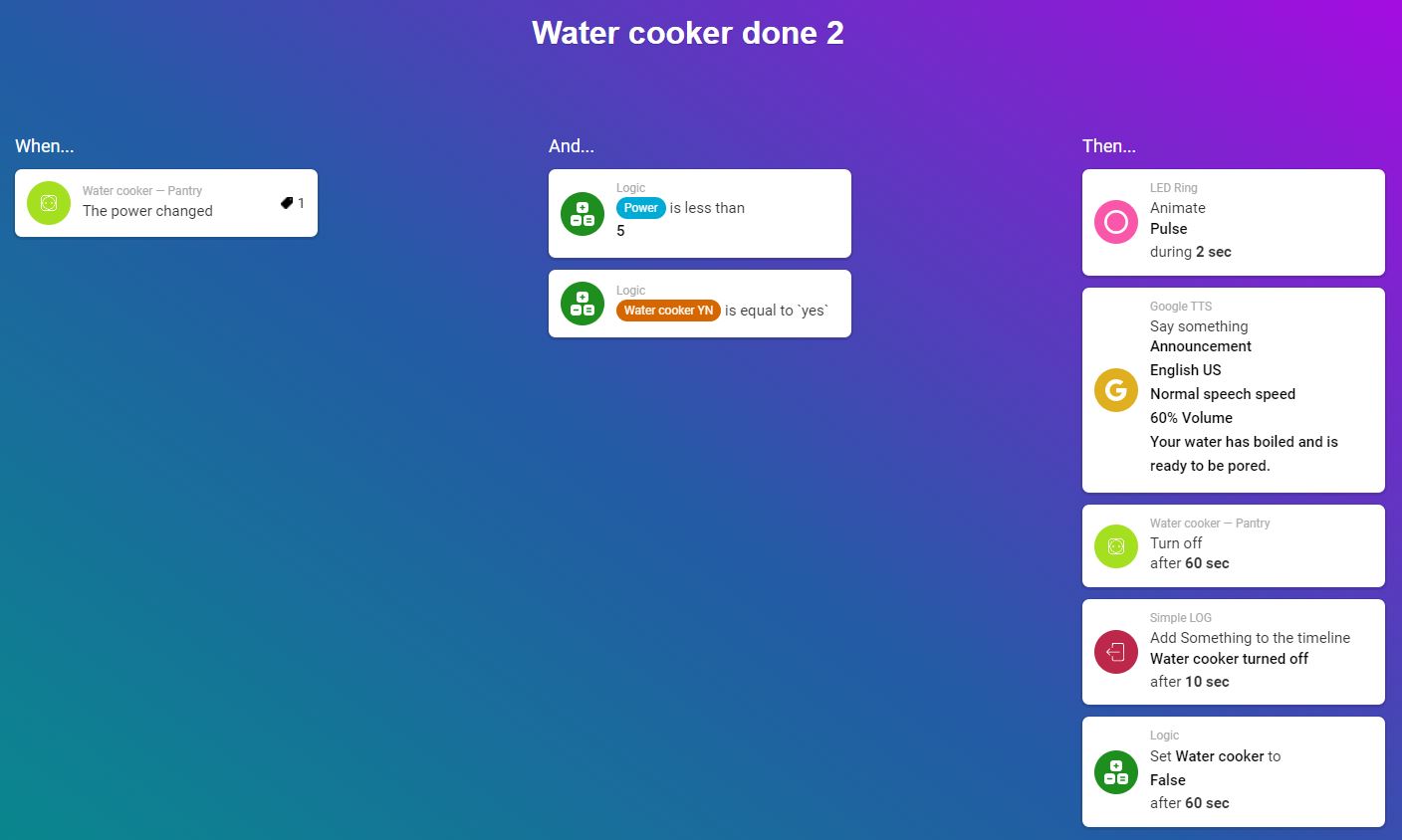

Hi Dirk, here are some screenshots of the 2 flows.

Ok, found the problem. In the second flow you are using an other / a wrong variable in the „And…“ section (Water cooker YN). What is this variable for?
So the variable „Water cooker“ is not checked. But this is necessary for the Smart Watch to work.
But we will „see“ us later…
I’ve got this variable part from your example.
Okay, I guess you didn’t understand me.
You use 2 different variables in your flows:
- Water cooker.
- Water cooker YN
This is wrong. You must use the same variable in both flows. Please use only the variable “Water cooker”.
