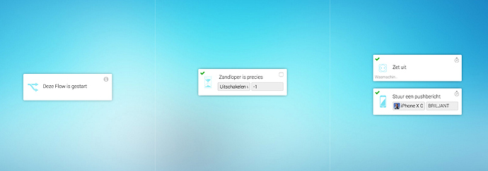

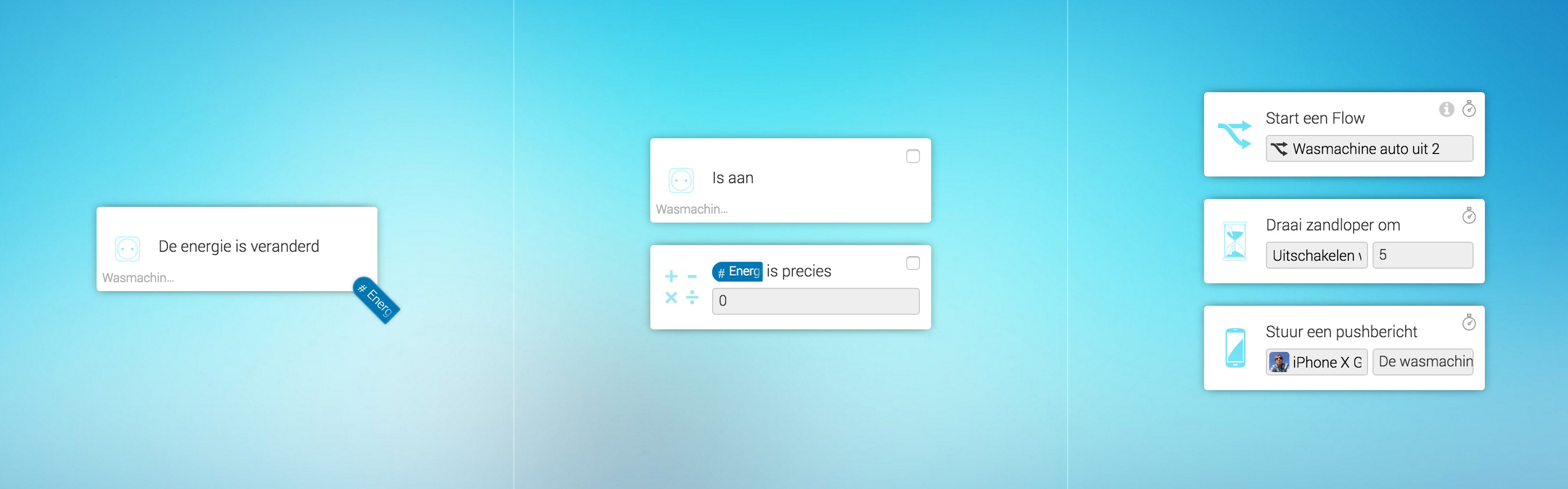

Yeah use the countdown app. When the power is 0 watts start countdown 10 min. When timer is finished en power is still 0 watts turn off socket. You have to make 2 flows for this.

OK Thanks! I have the whole evening trying it :face_with_raised_eyebrow:
Hey. I made this. Flow 1 and Flow 2 see the photos. It works independently of each other. Together no way :tired_face:
Do you have any additions to make this work?
It works :facepunch: Thanks
