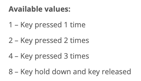

The dimmer has no “Scene Activation” with only “held down”:
With “held up/down” you dim the lamps that are connected to the Fibaro Walli Dimmer.

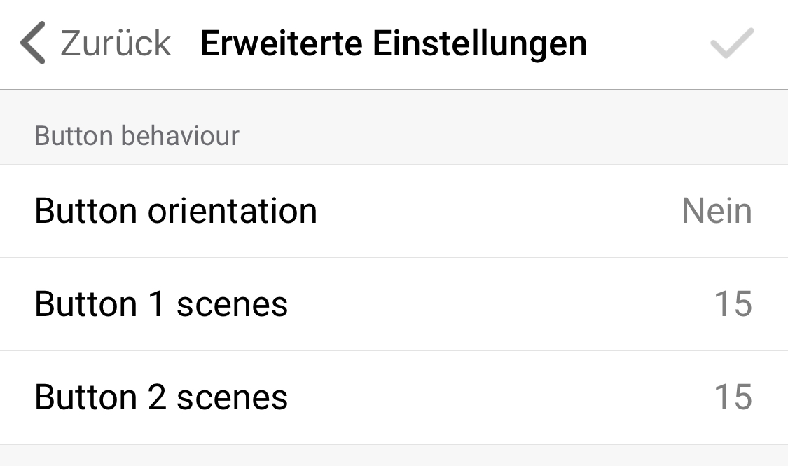

Btw, to be able to use all variants of “Scene Activation”, a 15 must be filled in at “Button 1 scenes” and “Button 2 scenes” in the advanced device settings:
So in the advanced settings of the Walli Switch you have to fill in the NodeID no. of the Walli Dimmer in Group 2 for “On/Off” and in Group 3 for “Dimmer”.
I have one Walli Switch and one Walli dimmer and want them to control the same lights. It is just the dimmer that is connected directly to the lights and the switch has just power. So my concern is how to program the walli switch to send instruction on/off to the walli dimmer.
Cool! Changing it to “Scene 1 scenes: 15” and “Scene 2 scenes: 15” solved my problem. Now the dimmer get triggered on “Key hold down”…I don’t understand the logic here, but it works :slight_smile:
